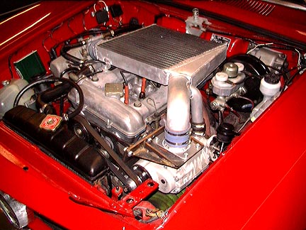

A friend in DK sent me this pic of the engine compartment of the Alfetta GTV with the Rotrex supercharged TS engine.

Geez sometimes i think this site is taken a little too seriously :o i posted that pic because i thought how the SC was mounted might be of interest, not the fact its a second hand toyota blower thru carbs :D ................
