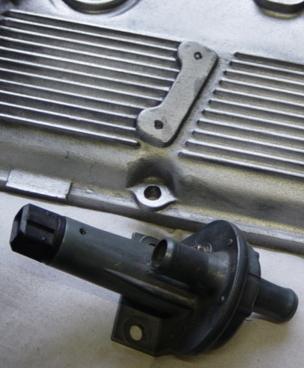

Also, what needs to be done with the AAV, and why? This is something I have completely missed.

The AAV is still needed with the MS, I'm not sure how the Motronic handles the cold start warmup where extra air is needed.

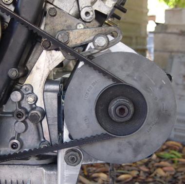

You may have noticed the different alternator, it's off a Merc, not sure what model, but as an 85amp upgrade it fitted easily, just a minor change to the bottom and top spacers.
Does you car have air conditioning? You will need to drill and tap the top AC compressor mount bolt hole.

- Merc 85 amp alternator.
- ALT1.JPG (25.28 KiB) Viewed 13665 times

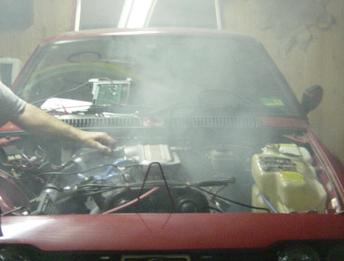

- The first startup. Just the paint burning off the extractors.
- MT1.JPG (11.52 KiB) Viewed 13666 times

I´m using the alternator belonging to the 3.0QV engine. It doesn´t really line up, so I´m putting a "dubble" wheel from a VW on it and will use the outer of them. (was that understandable?

If the Motronic needs the AAV, what will have to be done? Do you know?

I am 99% sure the Motronic AAV is controled by the computer, so its not the same AAV.

Seb,
The AAV holes only need drilling and tapping. The place to mount it is the same as the 2.5.

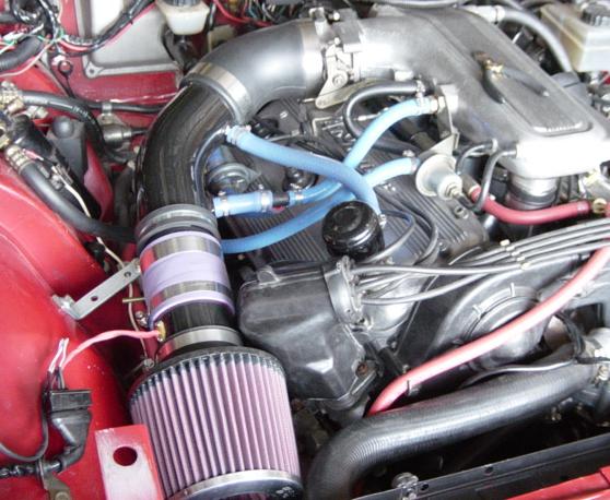

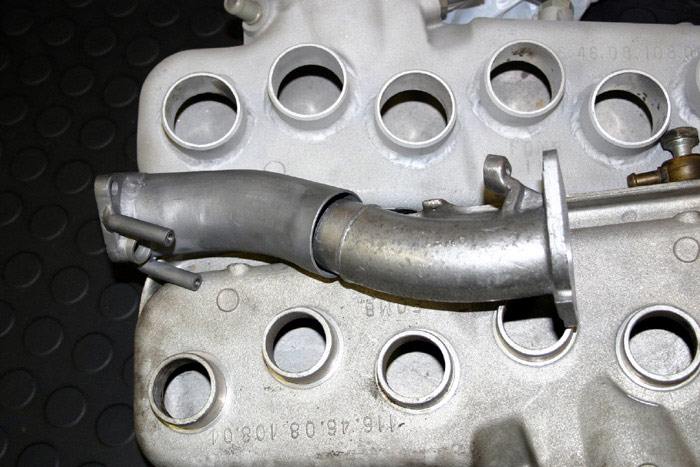

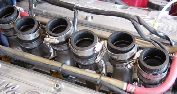

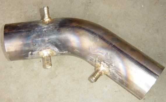

- Air intake under construction. An off the shelf 75mm exhaust bend from the local truck spares.
The 75mm rubber joiner to the throttle body is a stock truck spare as well. - AI1.JPG (25.86 KiB) Viewed 13621 times

Nice intake!
The stock runners are good enough - ported to 39mm - to step up the 2.5, but a 3.0 needs new, bigger, cast jobbies... (maybe even 44mm or so...)
Also, on the intake plenum, try welding in 50mm stubs up top rather than porting out the existing stubs. (see my pic below...)
David I LOVE that intake that you made. (On the MS, you got rid of the AFM or what did you do with it?)
I still need to find time to install the GoTech on my street Verde and an intake pipe setup like yours would be great! (With the GoTech you completely drop the AFM), so this setup will work and it looks professional - big as it'll go and gone with the restrictive accordion hoses and crap!
What "truck" parts are those sections from?
- IMG_0289.jpg (93.59 KiB) Viewed 13601 times
The bigger runners on the plenum would have been better but I'm not sure there's much to gain on a stock 3.0L particularly with the new intake. That's my next project, and this plenum will then go on my 2.5 GTV6 with a new intake and Megasquirt.
Yes with Megasquirt the AFM is gone completely. 75mm straight through from the air filter to the throttle body. I just love the sound of the intake under full load. The pipe is coated with POR15, a good hard glossy finish, using a brush!
You will note the Air Temperature Sensor (from an old AFM) near the filter. The other 2 wires are from the O2 sensor I welded into back of one of the extractor banks. MS users both of these for input data.
The "truck parts" are: 75mm 45 degree exhaust pipe bend, 75mm 45 degree rubber air intake joiner, clamps to match. The brass pipe fittings are brazed into the pipe. I purchased the new K&N at a clearance sale and the whole lot excluding the runners, cost $130 AUD
I will post the runner construction under a new topic. I didn't mean to hijack Seb's thread but most of the issues are common to 3.0L conversions and it's always great to see & hear other ideas.
David
David

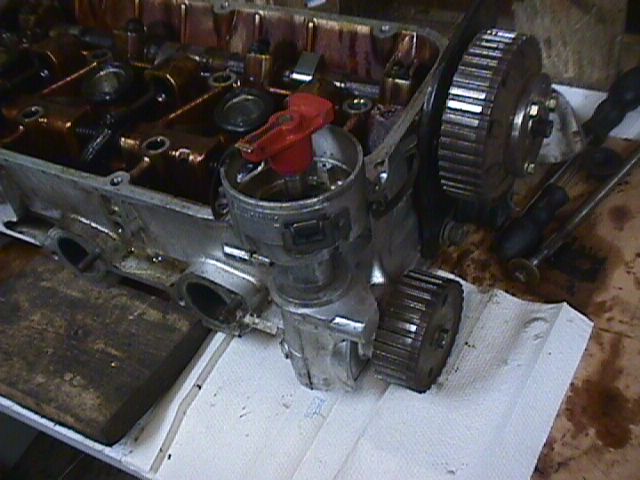

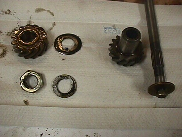

Hey guys!

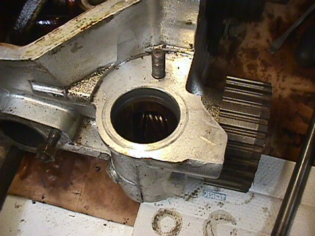

Good to see my thread´s generating some discussion. One of the reasons I went with the 164 plenum is my engine is a QV (S). The runners are bigger stock on it, I think 45mm.
Anyways, last night I continued with the work changing the gear for the dizzy/oil pump. It all went smoothly for once.
I´d allready taken the head off and removed the gear in the QV. Now I had to do the same with the 2.5 donor engine and get the gear from it in the QV instead. Fits right over, no probs.

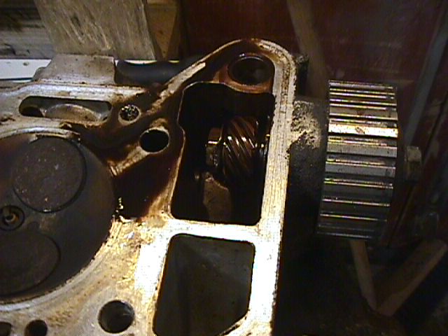

- Here´s the 2.5 top up-side-down with the gear showing
- MVC-001F.JPG (50.07 KiB) Viewed 13580 times
- It´s now hard to do, a bit tight maybe...
- MVC-005F.JPG (42.98 KiB) Viewed 13580 times

Well in place I had to check it really worked, and it did. Hopefully now I have timeing again
In the picture below the gear involved in this. To the left the gear I had to change, and to the right the one on the axle that spinns the dizzy.
- dizzy in place and it seems to work...
- MVC-010F.JPG (53.11 KiB) Viewed 13568 times
- Gear showing through the hole where the dizzy goes
- MVC-009F.JPG (59.29 KiB) Viewed 13568 times
- The gears involved
- MVC-008F.JPG (45 KiB) Viewed 13567 times

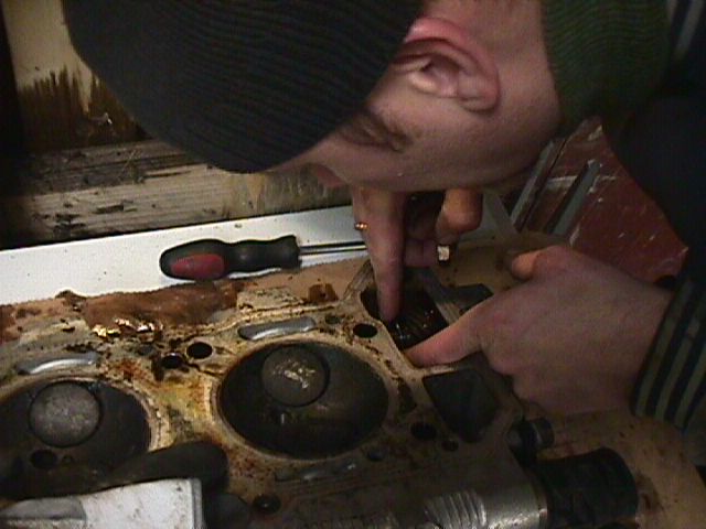

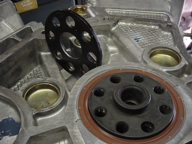

next little project:
Get the cam wheel off so I can remove the 164 top engine mount. Doesn´t look too good sittign there.
Stuck like hell thoug, any tips on removing it? Guess I´ll just use one of those things used to pull stearing wheels of with. (don´t know the name in english).
´til next time dudes!
/Seb

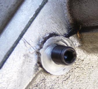

Seb,
Use the puller and give it a slight tap. Watch it though they sometimes come off with pop.
One of the holes where the top FWD engine mount is fixed goes right through to the tappet area. You'll have to plug it with a hex screw or a short bolt and washer.
David
David
- I used hex plugs in all the holes where studs were removed.
- H1.JPG (20.98 KiB) Viewed 13569 times
