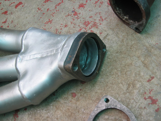

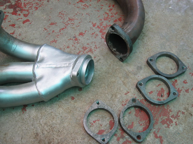

Hey Z , I have a copy on disc some where. I had inners and outers made. ie inners were tapped with8mm thread and outer with a ten mm hole. tThe inner flange also was a 1mm in diameter smaller so the "locating sleeve" could fit easier into the outer. I think this will only make sense seen the pics. The reason for this "sleave" was because the two bolts opposite each other and the small outside surface area did not form a tight enough seal.
Just realised this disc wont help you as these are 58mm inside diameters . Lenz still got a spare set for you if you want,-free.
