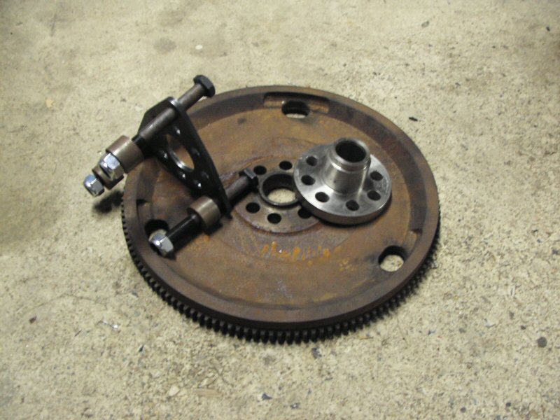

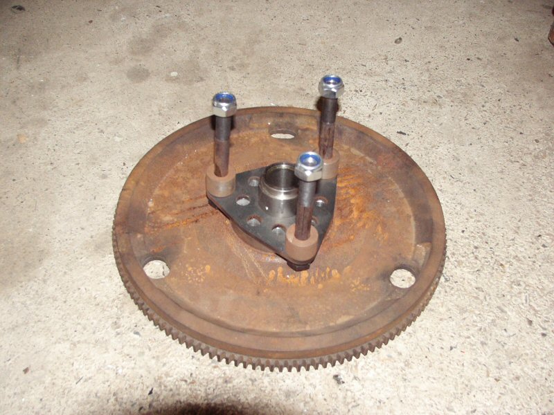

Here's what I'm talking about with adapting the 24v flywheel to gtv6 tailshaft.
Flywheel adapter 2.jpg (114.07 KiB) Viewed 11280 times
Flywheel adapter 1.jpg (102.41 KiB) Viewed 11281 times

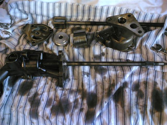

Zamani wrote: Oil pump wise, do you just change the pickup?
No, I used the housing from the 12V (from 75 3.0) and the internal parts from 24V.
I also had to press the axis about 5.5 mm into the rotor to adjust the lenght. Notice the original position of the splines on the picture with the shafts side by side.

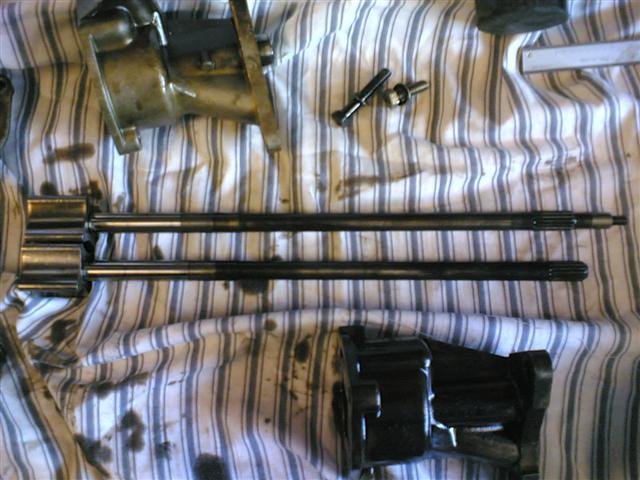

Oilpump shafts before modification
20070210(002) (Small).jpg (55.85 KiB) Viewed 10417 times

Here are the 24v shaft after pressing a little on the axis to get the correct length
20070210(004) (Small).jpg (28.67 KiB) Viewed 10411 times

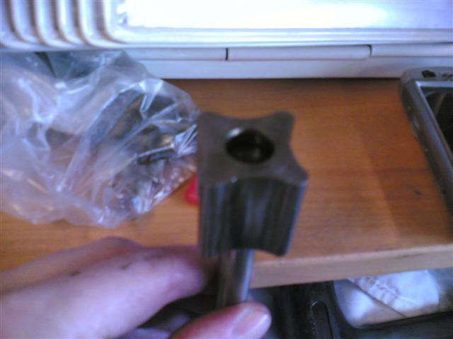

Has anyone else pushed this oil pump axis out from the shaft before? Im having some issues trying to do that. Methods on how would be greatly appreciated!
Thanks

Uhm,getting the SOFT,VERY SOFT gerotor off the shaft is a delicate operation.
Its incredibly soft material and even light force will distort it..
Id rather not do it unless neccesitated to do so.
