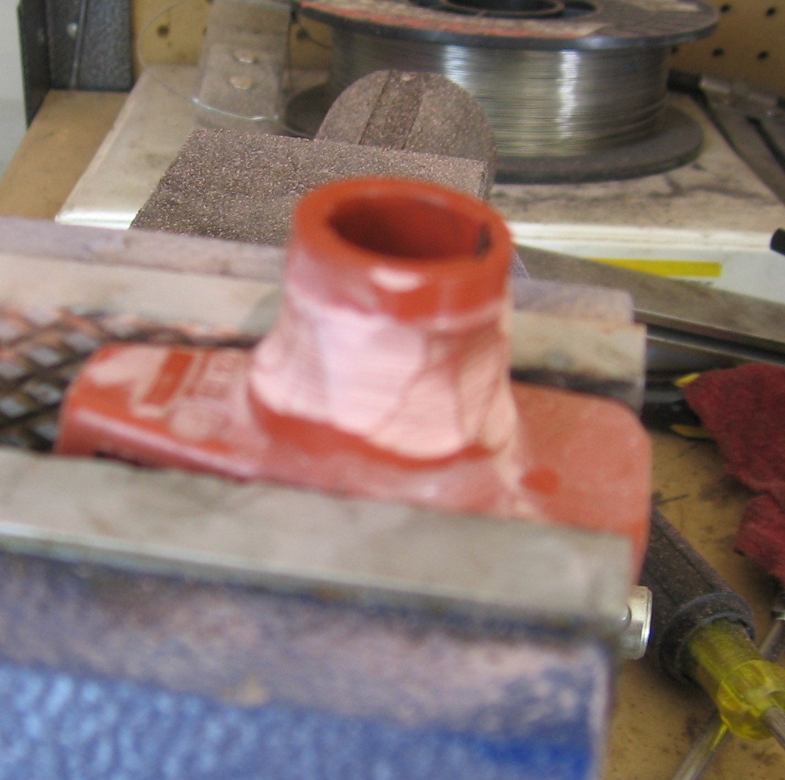

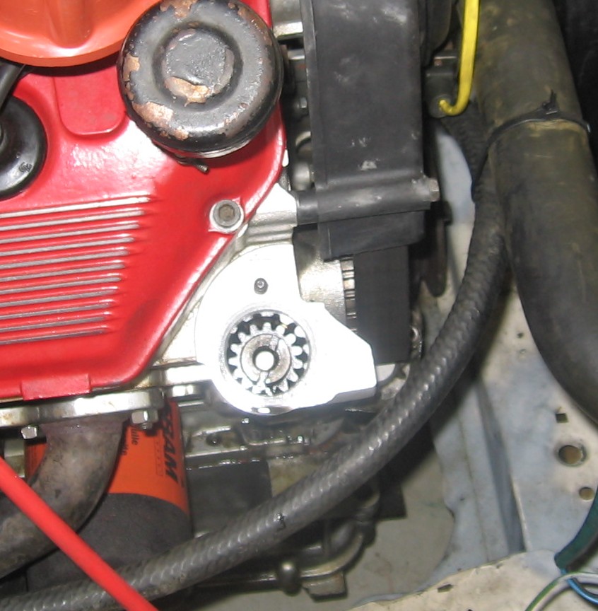

- whatch out for rotor/dizzy/chopper wheel phasing!!
- IMG_2253.JPG (140.57 KiB) Viewed 8521 times
- rough install location
- system.JPG (145.95 KiB) Viewed 8521 times
- have to grind edge of rotor to get it to fit with new optical sensor

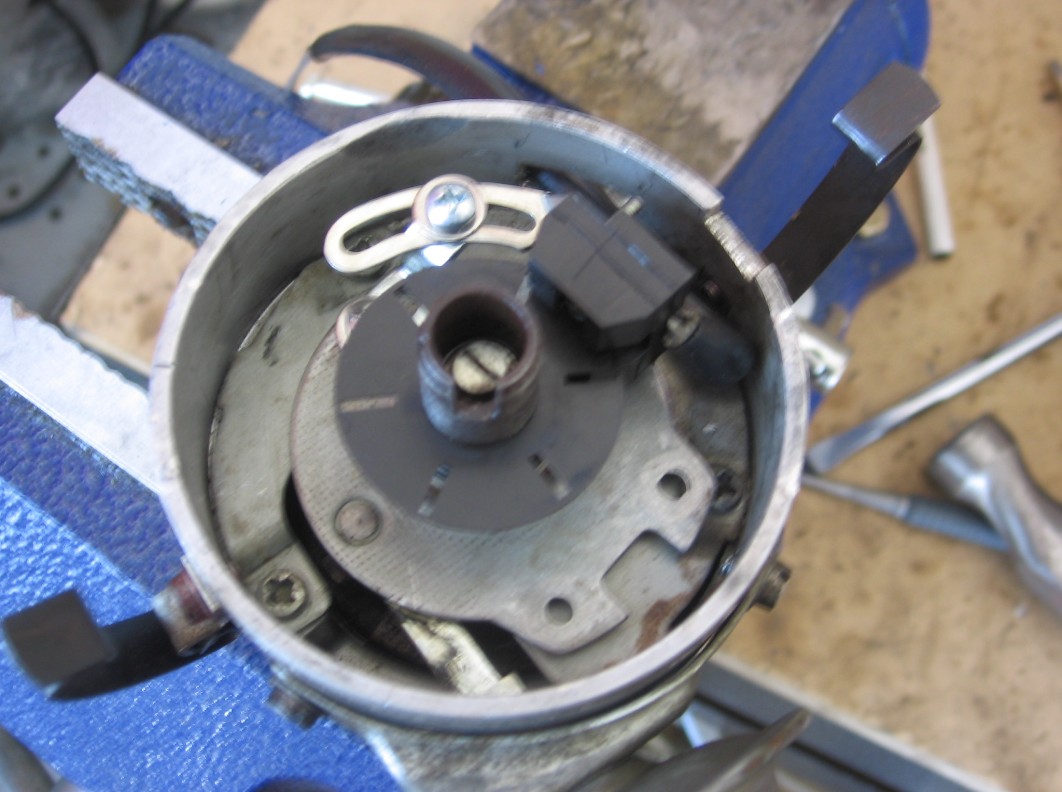

- IMG_2258.JPG (176.4 KiB) Viewed 8521 times
- hardware install in dizzy...new optical sensor and adjusting bracket

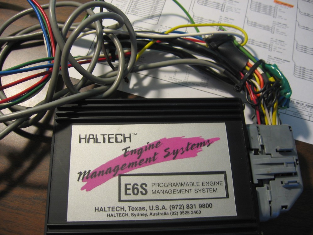

Anyway..look what i found in my spare electrical box...Haltech e6s
I think I can get this to trigger from the coil or optical sensor in the dizzy. Since I will use the Crane for timing, I can use the Haltech in Multipoint setup so no need for Home trigger.
Haltech to run fuel map based on rpm , TPS, and manifold baro and temp sensor (and I can get rid of air flapper!)
Crane to do ignition...
I will just use a common trigger! and it's free (hope it still works)
what do you guys think...crazy..stupid...why not just get GoTech...!?
Free is the reason..oh yeah..and the challenge!
