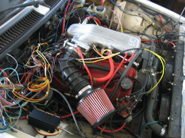

Haltech in...started right up.
The Hal'win' computer program VERY easy to use..you can open several maps at one time. Also, there is a guage face window which is real easy to check everything at a glance...
Running a 'little' rich right now.......
F10x was made for this engine!
Took her on the road for a few miles with some coarse tuning of injectors...
GUESS WHAT...no more hesitation or sputtering at 3500 rpm or when turning...
my guess: a short or 'almost' broken wire in the harness which I will never find
Anyway..at least I can sleep tonight
Dude, the wire-monster threw up in your engine bay... 8)
Great to hear the engine runs fine now, and it was such an easy fix too! :D :wink:

shouldn't the cigarette seals be sticking out a little when installed? :?
Rice SAE
..all depends on how long you been smokin' it .. :D
I would think yes to allow it to be driven fully home by the bearing cap.
..hey Luciano de Pasquale rad. Ma why u no put some sauce on dat wiring harness, eh ?? !! :D
Got yourself a job and-a-half there fella. Just don't lick your fingers when you're finished.
even if the cig seals are sticking out just a little, it does not mean that they have been fully seated at their other end...i like to drive them in as far as possible until flush and just trim off little peripheral excess flashing. Then i fill and gaps w/permatex..this way I know they have been driven all the way in....
da sauce is for da Sunday dinner....
