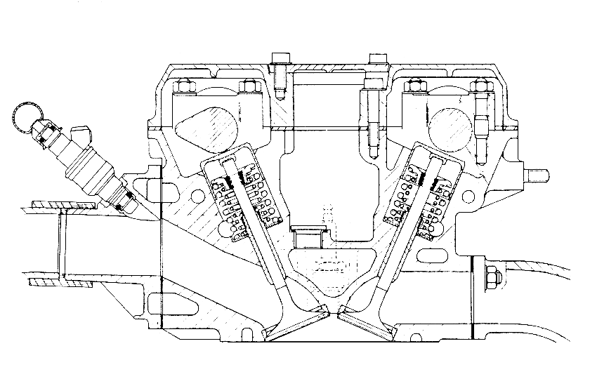

I've also included a section drawing of the 75 TS cylinder head and manifold . . . sorry I don't have one for the 155.

On this section the water jackets around the intake tracts on the 75 heads is obvious.

Drawing shows injector just outboard of head so no relief for the injector on the head itself. Yikes! that looks like a pretty good kink in the inlet tract where the manifold bolts up to the head and it looks like the injector could be shrouded by the fact its not really in the tract itself.

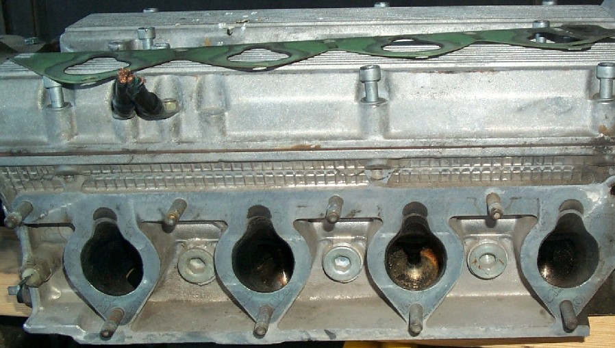

Attached is photo close up showing the access plugs to water jacket. I posted a close up of stock condition of water jacket access plugs

Thanks Ross. That whole area surrounded with the little wall in your pics is actually a water jacket on the 75 TS engines.
The injector on the 75 squirts fuel straight at the valve so probably no shrouding effect at all, very efficient I think, but the air is a bit different with the kink in the intake. Actually it's not as bad as in that section, there is a small radius in the "mouth" of the head.

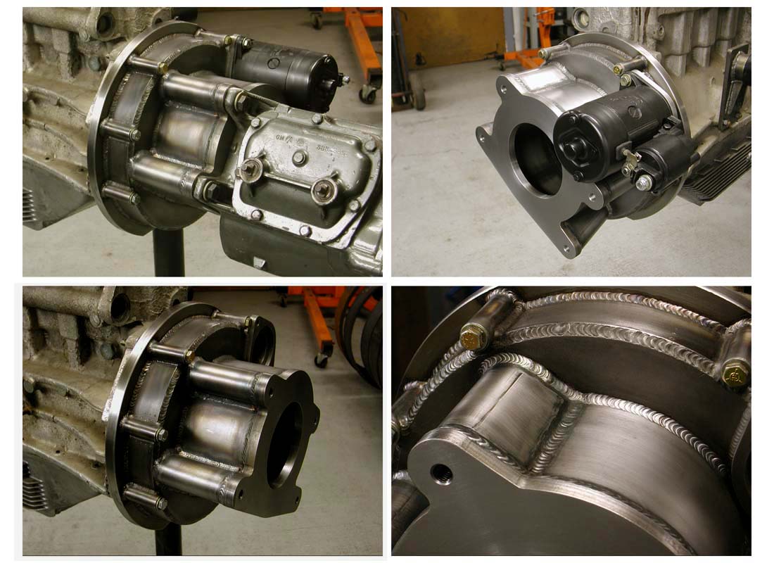

Overall, the FWD engine is much shorter. The rear of the block is shortened and the timing cover is shortened. A 105 bellhousing and flywheel will not work with a 164 or 155 block without an adapter. The Bonneville engine (155 block) needed a stronger transmission and a 1/4 inch thick steel scattershield to meet safety rules, so I needed to make a custom bellhousing anyway. Here is the the bellhousing/scattershield. BTW, the requirement for 360° coverage is to keep parts off the course . . . protecting the next competitor from parts the course marshals may have missed. The rear-mounted starter makes room for a larger intercooler.

Interesting facts there Jim. Those scattershield/bellhousing pics are pure porn, some really nice welding going on there... :) But do you really need that enormous starter engine? Weight must be an issue even at Bonneville?

The starter is from a VW Rabbit . . . about the same weight as a 1600 starter. Trick was finding a reverse rotation starter with the same pinion. Weight is not the big issue at Bonneville. We gained only 1-2 mph per mile in the last two miles. Aero and horsepower are most important.
