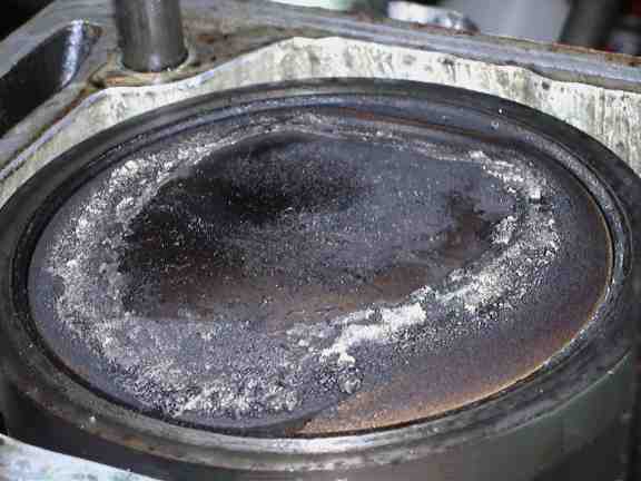

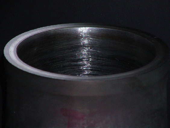

Well I got my engine disassembled to the point where I can examine the pistons liners and valves.I'm pleasantly surprised.Liners look really good-no scratches can still see the factory cross hatching even on the top and bottom wear surfaces.I was surprised to find a fair bit of carbon build-up on the piston tops -given how this engine is driven but I guess that could be related to oil leaking down the valve stems.I cleaned one piston top with a plastic scraper and carb cleaner and it looks like new.Guess I'll keep the pistons and liners and just go with Total-Seal rings and a 90 deg.liner rotation.

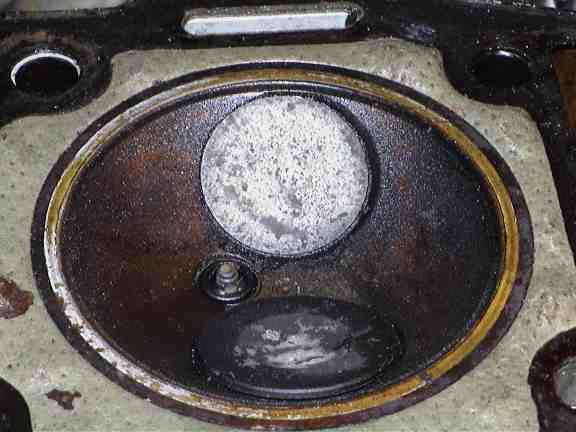

These picts.show the worst of the 6 cylinders and combustion chambers.The rest are quite a bit cleaner.I'll measure the valve stems before deciding if I replace the valves.
I feel really lucky-The heads slid right off and I am able to rotate all six liners so they should come out no sweat.I've read about other peoples problems with these two items and was concerned they would slow me down.

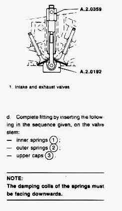

Next question:This section taken from the Alfa shop manual states that the valve springs must be oriented in a particular way.Looking at them both ends look the same,ie:the ends of the springs coils are flattened out.Any ideas what Alfa means?
