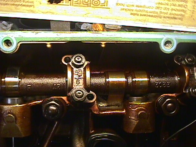

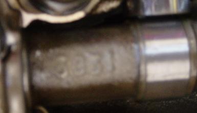

By the way, while you have the head off the 3.0L, what markings are on the cam shafts. I'm trying to find out what's in mine with markings as per the following.
David
Cam Letter.JPG (4.74 KiB) Viewed 14048 times
Cam Numbers.JPG (8.76 KiB) Viewed 14049 times

I will have a look David, next time I´m in the garage.
I would think the "S" means you have the cams from a QV (S) engine. (200bhp stock) Thats what I have since my whole engine is from a 164QV .

I´ve checked out my cams and they seem to be the same as Yours.
One says 30 31 and the other 30 33. I can´t find a marking like the "S" you have, but thay are prutty oily. Hope You have any help from this!

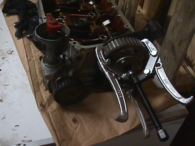

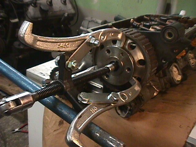

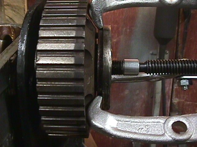

But now, I have a problem, maybe one of you can help me.
Im trying to get the cam wheel off, but its stuck as hell. I´ve used a puller, banged on it, heated it, ripped my hair out and puked blood! How do I get the little fu**er off?
I´ve loosened the center nut, and the three bolts in the plate outside the wheel. The wheel is loose and is ratteling in an anoying way inside the plate, but the plate doesn´t move!
If anyone of you hav e good tip I´d really appreciate it!
/Seb
some pics:

Seb:
I seen you try to pull on the hub. I just loosen the center nut and pull on the wheel itself. Just tighten up and give the puller a hit with a hammer now and then.

Jarle!
I tried that first. But since nothing happened I changed taktics. I wasn´t sure how much force the wheel could handle. I pulled hard on it!! And banged on the puller shaft. Well, I´ll keep trying...

Seb,
In my experience you have to keep releasing the puller jaws and rotate around the "support hub" so that the pulling force is distributed around the circumferance.Once you've gone around once set your puller and crank it almost to the point where you think you're going to break the hub or the puller.Be carefull because when it pops off it will fly across the garage.Ask me how I know this !

OK, thanks guys!
Murray, did you pull on the hub or on tha wheel? My puller doesn´t grip to well on the hub. If I crank it too hard it slips. In that sence maybe it´s better to pull on the wheel itself. (?)

I didn't read the whole thread but did you guys know there's a factory Alfa tool for this? It screws into the 3 bolt holes on the balance plate in the front of the cam sprocket sort of like the steering wheel puller.
Perhaps 3 bolts into a home made tool would be better than the 3-jaw puller. The sprocket itself is very soft metal.
The best would be to find someone local to you has the tool you can borrow. You'll need the cam locking tool and cam turning tool too when you go to reassemble.
Have a look at http://alfa.denovich.org/twiki/bin/view/Alfa. There are directions to make at least one of them.
