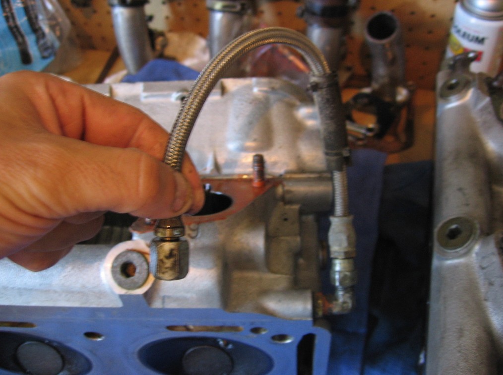

He blocked off the central oil tube in bottom of head and ran two independant braided feed lines up from the oil pressure sensor hole with an "X" fitting so the sensor still sit in near same location.

- rear plumbed oil line
- oil.JPG (134.29 KiB) Viewed 8029 times

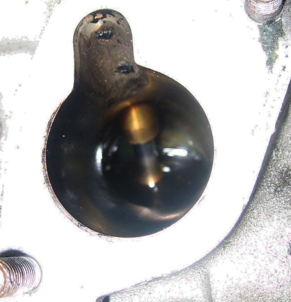

- smooth as glass (w/some dust on it)
- intake.JPG (177.59 KiB) Viewed 8030 times

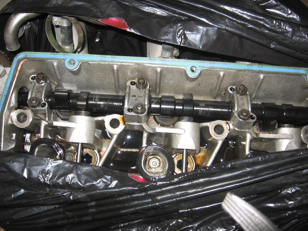

Took the worked heads completely apart. Prior builder went a little too far with the grinder along inside of follower bores: too much wobble of the followers now for me to be happy
also, exhaust arm guide rod(the big rod) in backward
also, all valve guide seals crushed because C+B cam lift was TOO much for the distance
SO, with my spare set of 3.0 heads..I plan to drill out center of lower valve spring washer and sink the intake valve guides ~5mm(plenty of room on other side). This along with minimal follower bore edge grinding will allow the C+B cams too work nicely without crushing anything...
anybody have other thoughts??
