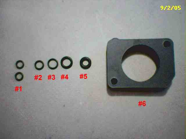

I ordered a complete set of OEM AR.engine rebuild gaskets and I'm at a loss to identify some of them.Can anyone help ?
#1 these are the O-rings to go around the roll pins in the head-oil passages.TSB from AR says not to use these with single piece head-gasket so I won't
#2 ?
#3 ?
# 4 ?
# 5 This is the idle speed O-ring
# 6 There are 12 of these.They are not for the intake tubes as I have already installed those.
#2 ?
#3 ?
# 4 ?

In addition to the foregoing plea for assistance I would like to ask your opinions re the O-rings for the oil-passage pins which protrude above the cylinder deck.AR have a technical bulletin which states that when using the "New" one-piece head gasket no O-ring should be installed as the seal is an integrated part of the head gasket.When I opened up my engine the O-rings were there inside the head gasket seal.I never had any leakage problems and am just wondering if I should install the additional O-rings or not ? By the way my oil pins are the split pin design-I know that Alfa had at least 3 different designs of pin.

So since no one has responded yet, I thought to keep you some company here and try the guessing game!
So... No 2,3,4 (and/or) may be for the hydraulic-tensioner???
I can't think were the 12 big no 6s can go in our L-jet V6... Maybe they are for the SA carburatted version???

Petros thank you very much.Your suggestions make perfect sense.I don't run a hydraulic tensioner hence the leftovers and yes the 12 gaskets could well be for another version of the 2.5L.I find this board has gone ominously quite since it restarted and it is important for all of us to communicate if we want to restore it to its previous status.

I've only rebuilt two 2.5L's and with the full gasket kits I have heap of spare O rings & odd gaskets and other bits. On the head gaskets, don't worry about adding extra O rings for the oil passages. The secret is to make sure you follow the head bolt re-tensioning recommendations, usually after the first 1,000 km or so.
I've done over 80,000km on one rebuild and 30,000km on the other and no leaks at all, not even the timing belt de-tensioner.

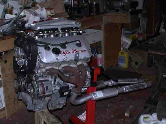

Ready to fly !
Well guys the voyage is almost complete-fingers crossed ! Now all I have to do is wait for the snow to melt off the roads enough so that I can start it up and do a 50km break-in cycle.
- EnginefinishS.jpg (15.96 KiB) Viewed 12817 times
Sure Dave.The downpipes are stock Euro pipes with resonators made by Cisam-OEM.I had an oxygen sensor fitting installed on one of the pipes and am connecting to a stock center exhaust and currently into a straight pipe at the back.I suspect I'll have to put my Ansa rear back on because removing the Cat is probably going to make it quite loud.Fortunately where I live the lack of a Cat is not a problem so I'm glad to be rid of that big ugly heavy section.
Dave we'll have to compare the "songs"of our sixes once they're fired up !.
No the snow is not gone yet !Calling for over a foot tonight.Man Georgia must be wonderfull this time of the year.You're probably already using your AC.
