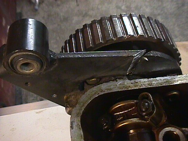

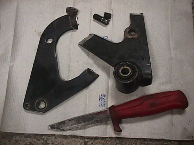

Problem solved!!
After trying for a few days to get the cam wheel of with no success, i resorted to other methods. I went to Violence´s bigger brother, Distruction, for help.
I had earlier dismissed cutting the engine mount off because off the tight spot between the head and the wheel. But with some precision cutting with the angle grinder and som ol´ fashion elbow grease and a metal saw it worked.
Thanks for all your help guys!
Now on to other challanges!
Seb
Seb
- The pieces...
- MVC-010F.JPG (42.14 KiB) Viewed 12594 times
- The first cut
- MVC-007F.JPG (48.91 KiB) Viewed 12594 times

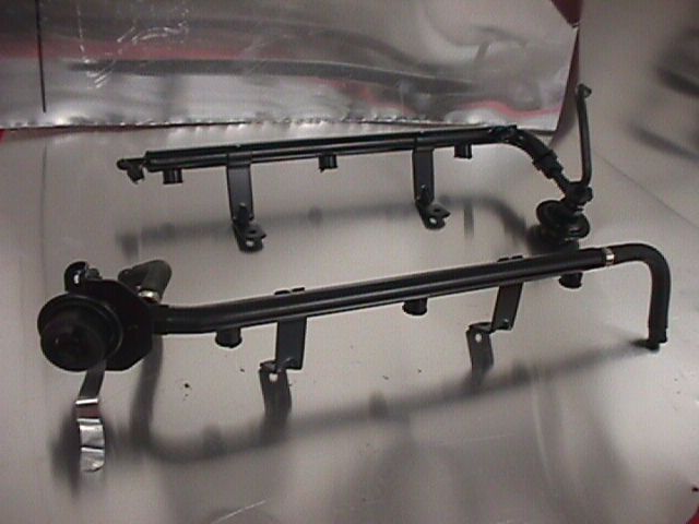

Let´s see, what´s happened with the GTV6 then... Well, I´ve started to hook up the wires from the motronic in the engine bay. Also I`v painted the fuel rails. They looked old and oxidated, so I decided to make them black. I´m using a "satin" black wich is really nice.
Will return with more pics soon.
Seb
Seb
- "Satin black" fuel rails
- MVC-022F.JPG (36.35 KiB) Viewed 12476 times

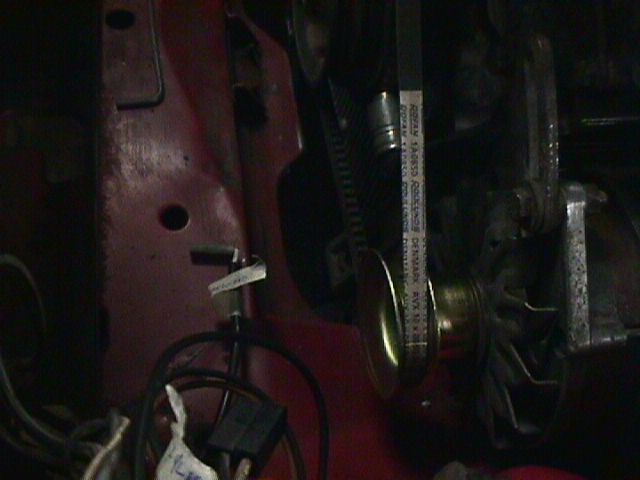

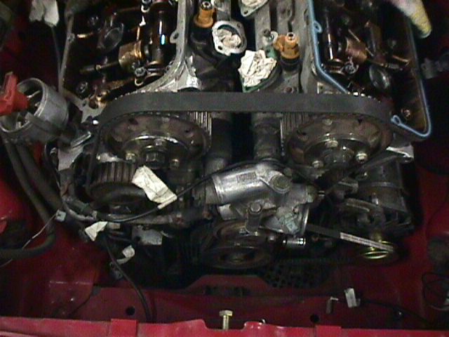

At last the top is back and I got the cam belt back on this weekend. The new gear for the dizzy and oil pump works great. (Phieuu..., drying my forehead)
Also the generator is back, but I had to change the wheel on it fro it to line up. (pics below)
All night last nigth I spent putting the driveshaft in place without splitting it and with engine and gear box in place... not the most fun I´ve ever had
But a few hours later it was done. (no pics, was too pissed off to remember...)
Seb

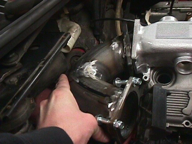

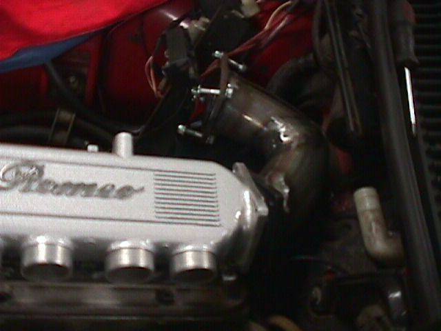

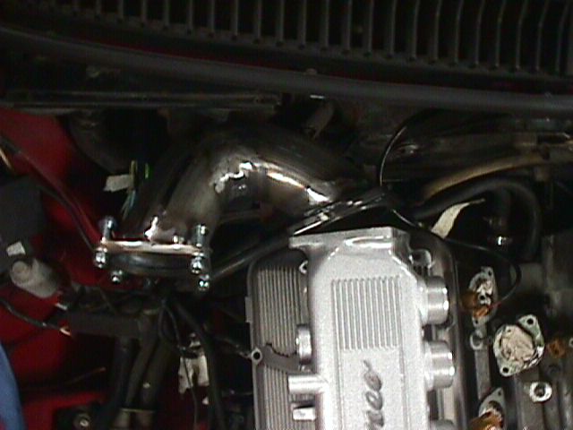

Hi guys!
Finally I´ve recieved the parts i was waiting for. The modifyed plenum and the 180 bend. The plenum is ok, but the bend is too wide. It interfere with the wiper engine, needs to be tighter. Now I will have to rebuild it myself. If anyone has any idea how to fix it I welcome it.
I have to find a tighter bend to replace this one with. A friend made this one but I´m a bit disappointed of the result.
pics below
pics below
- MVC-004F.JPG (45.41 KiB) Viewed 12288 times
- MVC-005F.JPG (33.43 KiB) Viewed 12287 times
- MVC-010F.JPG (41.46 KiB) Viewed 12287 times

Seb,
I personally would have turned the intake manifold 180 deg so that the intake is at the front, by doing what you have done you are asking air to do a U-turn into the intake chamber , this will cost you power - at least 5hp.
