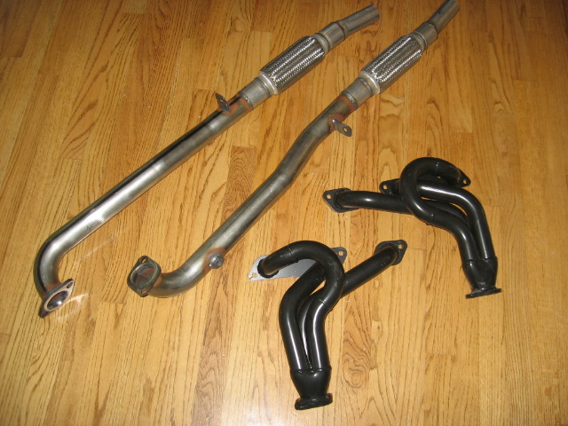

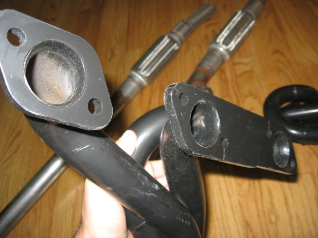

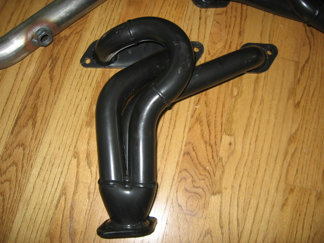

IAP headers just received:
look well built, nice smoothing on flange where it meets the pipes...
pipes are not all exactly equal in length, but I just want good fit for now..
Unfortunately, these are painted steel, not stainless.......but for 600$, who really cares
and they come with the down pipes
size:....1.5" primary ID at head flange...2" downpipe flange through the flex joints and then 1 3/4 stub to cats
O2 bung already welded in on one side..

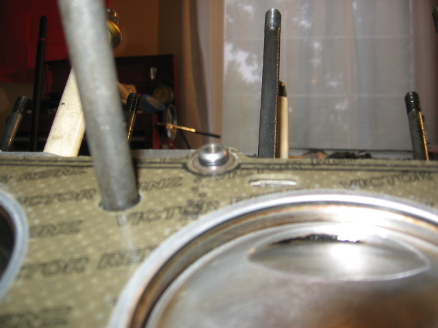

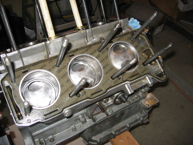

Reinz gasket..a thing of beauty.. i cleaned the metal mating surfaces of head and block and liners w/acetone to remove and dirt/grease/oil
close-up of rubber ring (supplied w/gasket) all holes line up

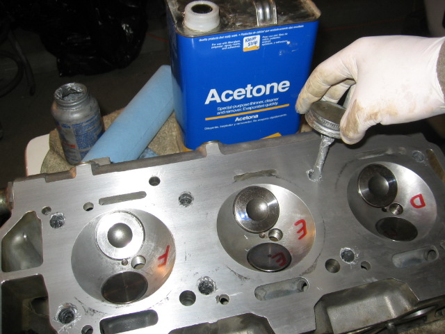

before putting head on, I put a little aluminum antisieze in head stud holes.  put it in holes rather than on studs and it will not build up on head surface as u slide the head on. Clean up any extra...

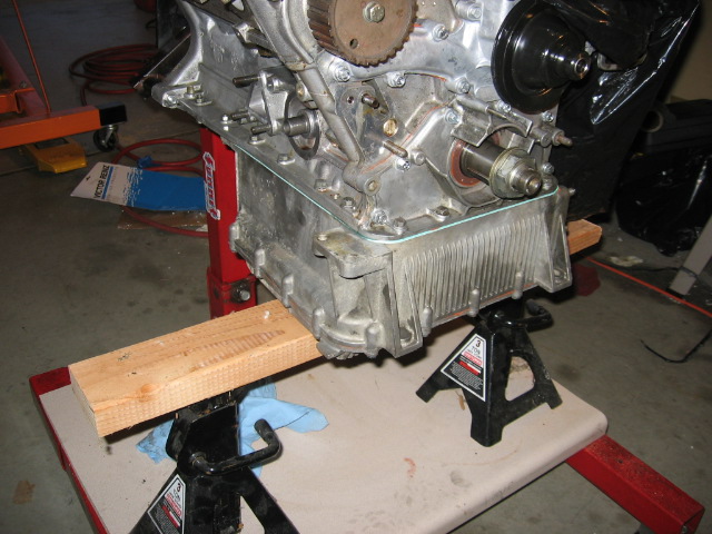

cheap Harbor Freight engine stand..I don't want to stress the block or the stand...so for extra support when heads are on, I use this setup

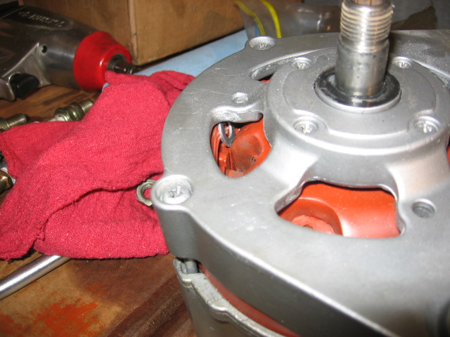

NOTE: anyone making my alternator suggestion change READ THIS: you don't have to grind the front of 90 amp BMW alternator to get it to fit. Just drill out as described in earlier post. I had a bent mount which I did not notice at first. Fits perfectly with no grinding. If you did grind it, just make up the ground area with a few washers....
BUT MORE IMPORTANTLY:Not my typically good day in the shop...
Cleaned some parts in the dishwasher..bad idea once the wife found out!!
Got hit in the head with spring retainer..
stupid little washer fell into alternator(which was already mounted) and got stuck....

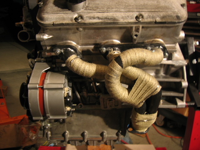

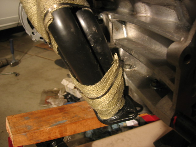

Header wrap to keep things a little cooler..this is DEI wrap..kinda hardens in place after first run
I soak it in water first to loosed the fibers, then stretch it tight when wrapping...dries tight
had to grind a little off the block where the collector came down too close...
also had to grind a flat spot in one weld for a nut..other than that header fit very well..
