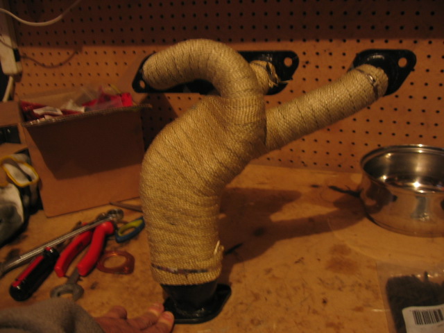

2Zig...I have tried high temp coatings (ceramic) but I find that nothing works better than wrap at keeping heat down. header can be red hot and you can still touch the wraped part..
also, this stuff is pretty durable and flexable and cheap, had it last for more than three years on a set of stainless headers..it actually never loosened or broke...but i eventually changed the header..
trade off is increased pipe wall heat...

wrapping headers is an artform....

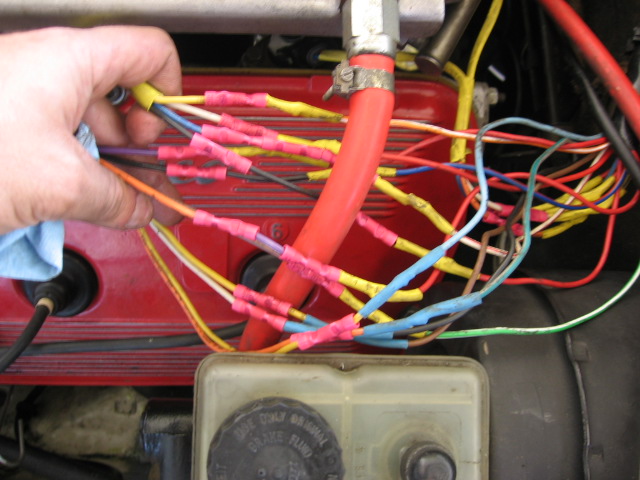

discussion in other thread about soldering v. crimps...well...I decided to give crimps a try (so much easier, too!!) do I have enough??
on another note...engine all done and old Bosch system back in and working fine...still have that hesitation problem...will switch out engines next weekend...
crimps v. solder....hmmmmm

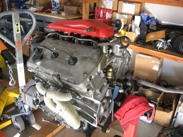

new old engine ready to go...
