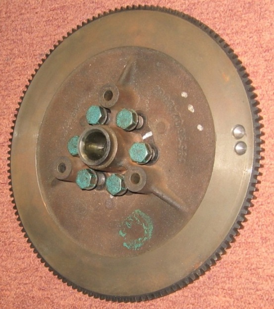

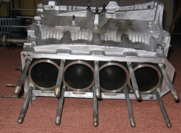

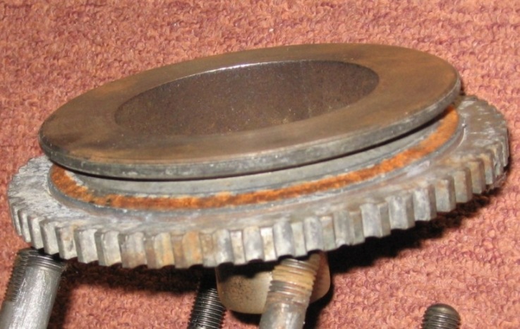

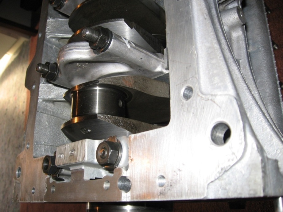

Post by Maurizio »
An update: machine shop is exit. They screwed up a set 155 pistons and balanced my crank assembly before I was asked, so couldn't round of the knifeedged crank :twisted:
And still after a full year nothing really finished :shock:
So what do I now have got now:
Balanced lightened crank.
Shot peened con rods with 0.5mm (shorter) offset bore.
Bottom end, line bore, new liners and main bearing 2 and 4 directly fed by oil channel.
Status: engine project is in the fridge due other house, a huge spare time consumption of current project @work and frustration.
TS_turbo
Posts: 185
Location: Bulgaria
Post by TS_turbo »
hmm nice how much is crank lightened :)
Maurizio
Posts: 680
Post by Maurizio »
Good question, no answer, never put it on a scale :oops:
