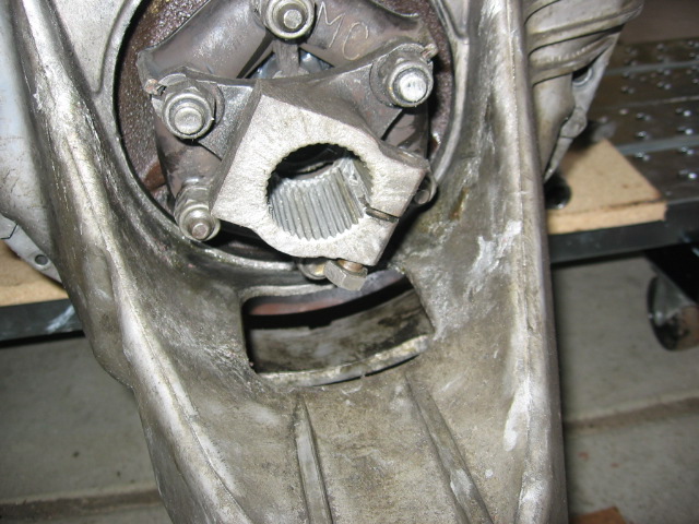

Now i'm pissed...It seems that I did not phase the rotor wrong...If I had looked more closely...I would have noticed that the dog teeth (which are slightly eccentric) at the bottom of the rotor shaft were pinned 180 degress differently on my two different rotors!!!

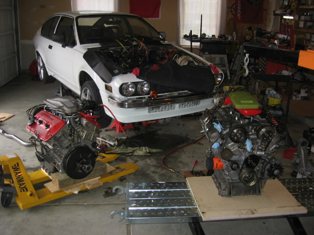

Started Frankenstein junior transplant today as I have checked every wire and connection and can't find the problem...
I went out for a ride and got about 5 miles from my house when a big puff of grey white smoke came out the ass of the alfa...
I limped back home and started the engine transplant. At least if the new engine runs badly..the problem will probably be wiring and I will tear out the old harness and rewire everything....
dog teeth on rotor..not all are placed the same as i have found out... by the way, these are great gloves called MaxiFoam..thin foam coat over woven mesh...really nice grip and thin enough to feel, but very strong and last a long time, never tear

Frankenstein Jr. almost ready for dissection...

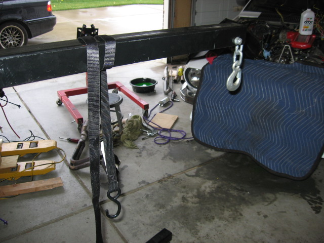

easy to tilt engine with front strap...just lower and slide back and lower until on the mounts

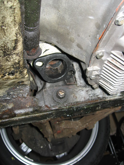

New header flanges soooo easy to reach...

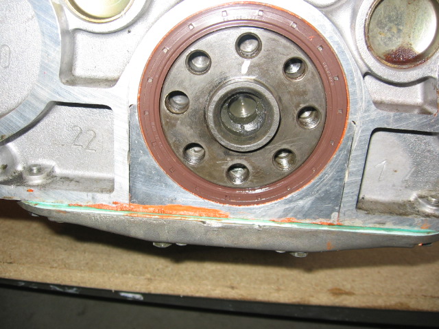

if you notice your flywheel bolts have two types of spacer/washers...two holes are closer together so flywheel can only go on one way
two of the crank holes are closer together so you can't screw up flywheel mounting
