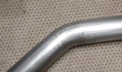

41mm ID exhaust pipe, mandrel bent to keep ID through the bend. Bend is 35 degrees.

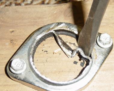

Chisel out the remaining bit. Not as hard as it looks as the flanges are brazed to the pipe and comes away quite easily. The bronze is also easy to grind out to take the larger pipe.
Cut the flanges off the original runners. Leave a bit of pipe sticking out to get the chisel behind.

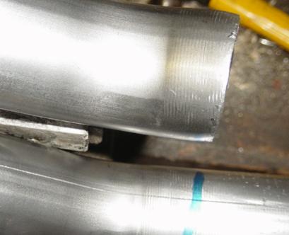

Press fit them into the flanges.

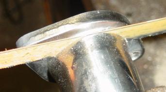

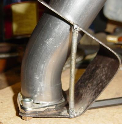

I made up a small jig to get the angle right,
Cutting the correct length and angle was the hardest part.

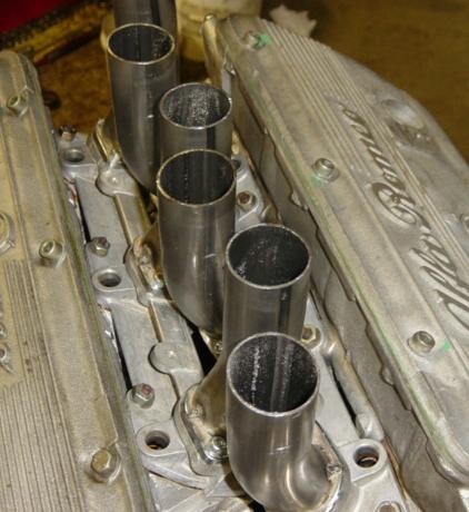

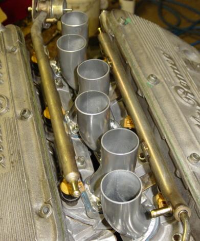

David
Finished
Finished
Cut off flat and coat as required.
Line them all up and tack in place.

That is beautiful! How much is that going to cost someone if you end up with nothing better to do than supply other people with that?

Cool, looks pretty straighforward !
Did you also enlarge the 6 Plenum outlets ? & how ?

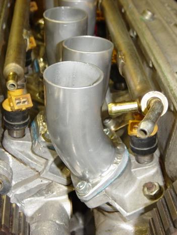

Steve,
The best you can get from the 2.5 plenum is 39-40mm, which I still think is enough for a stock 3.0L. The "flange" inside the original 3.0L runners is actually close to the ID of the 2.5 reamed out runners.
I used a good quality USA straight edge "reamer", not sure what they're called but they rip out the alloy quickly. I also used this to ream out the inlet flanges. The attached photo shows the 2.5 plenum and the tool.
