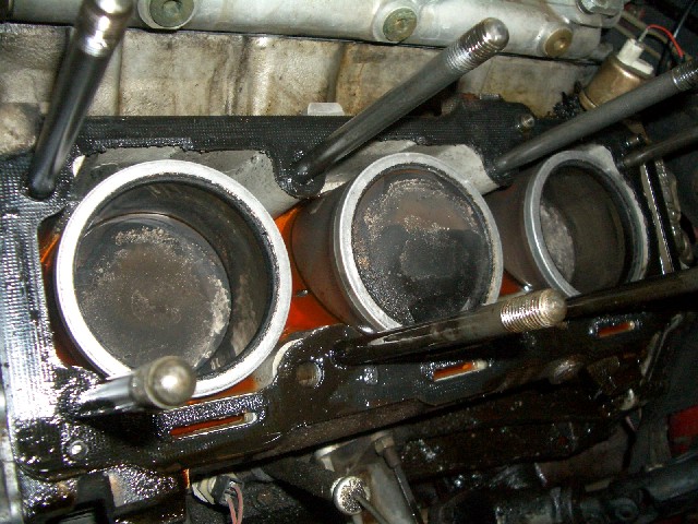

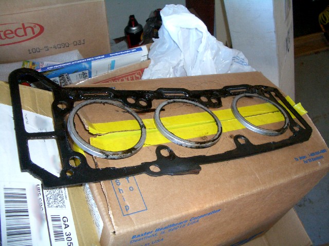

When we finally pulled the 1st head, we were in for quite a surprise. The car had original 2-piece gaskets! Are there any cars left out there with 2-piece gaskets?? They’re seriously scary looking gaskets. The rings that fit over the sleeves seem like a good way to go; it’s just the outer gasket that doesn’t exactly inspire confidence. It’s hard and shiny and seems to be made from a single compound, as opposed to modern gaskets with seal line traces encircling every orifice and bolt-hole. It also has a waffle texture, which I thought was odd.

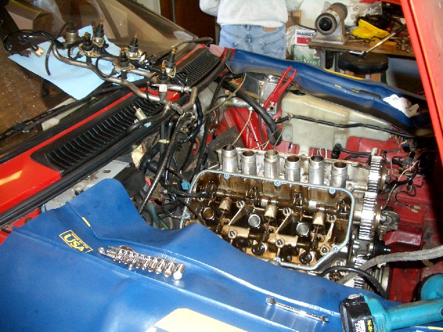

Oh well, pics attached…
Awaiting attention.JPG (51.05 KiB) Viewed 4139 times
Cam Covers off.JPG (127.44 KiB) Viewed 4138 times
Old style.JPG (93.13 KiB) Viewed 4139 times

You might want to burn those 2-piece gaskets! The ones that came from IAP are a lot more impressive.
