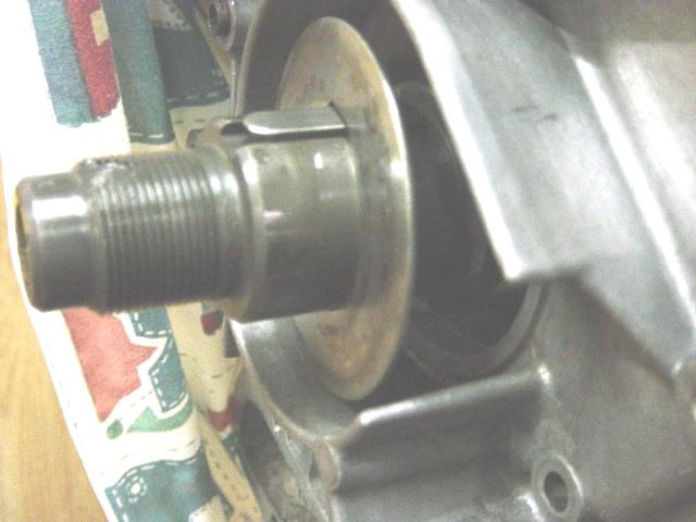

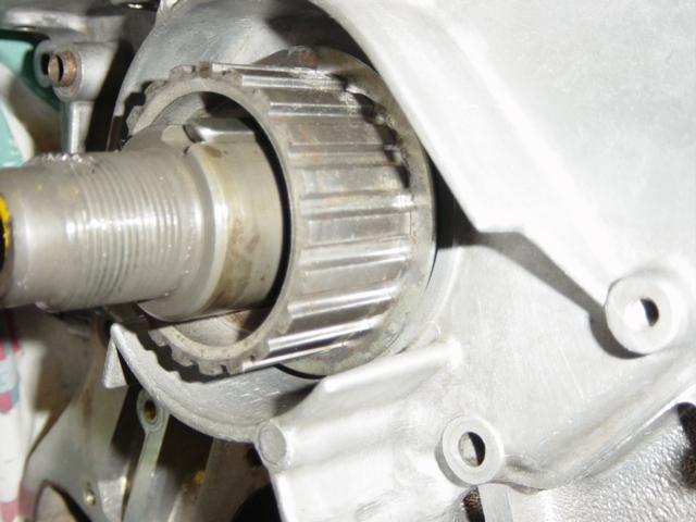

It's not just a matter of spacing the pulley out, the outer part of the washer acts as the guide for the belt. Here's a couple of photos. BTW the motor is upside down on an engine stand. My next 3.0L conversion.
David
David
- Washer
- DSC03660 (Small).JPG (34.24 KiB) Viewed 5558 times
- DSC03663 (Small).JPG (41.43 KiB) Viewed 5557 times
