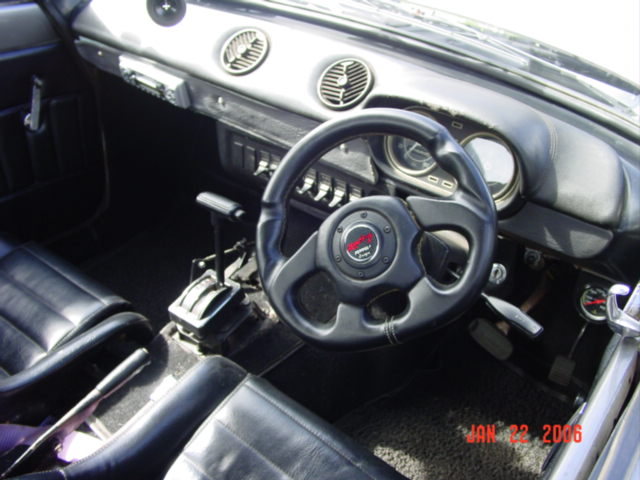

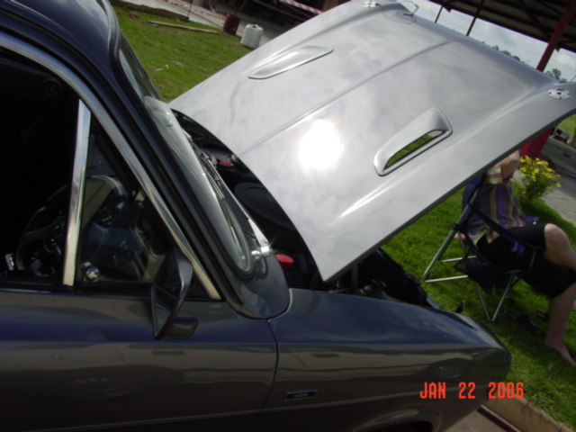

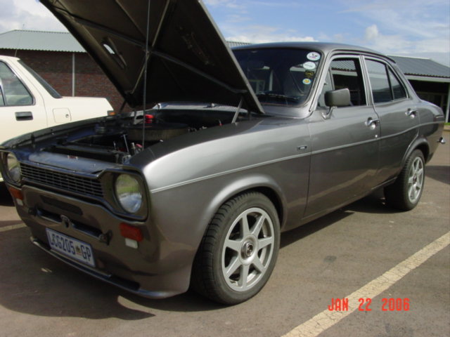

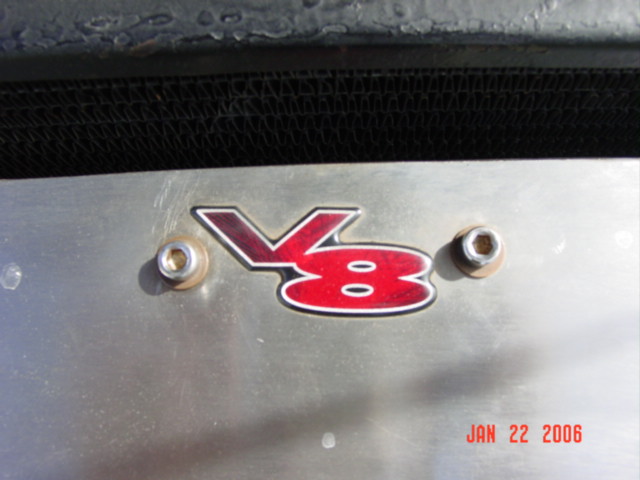

Just thought that I would share what I just saw in South Africa...
If this guy can put in a small block Chevy, you can certainly drop the Alfa heart in the Escort and feel good about it!
Cheers, JvR
