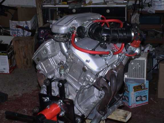

Yes I used that type of stand- no problem.You have to use some washers to get everything snuggly bolted up,make sure that you don't bottom out the bolts in the engine block holes.I also used a wooden support under the oil pan as there is a lot of weight hanging out there.

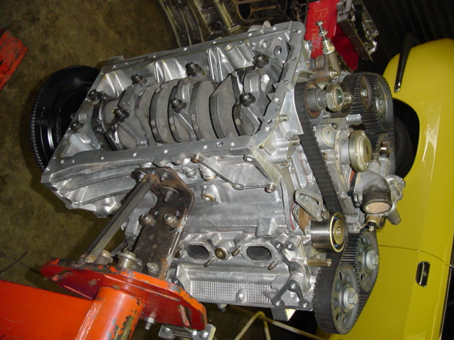

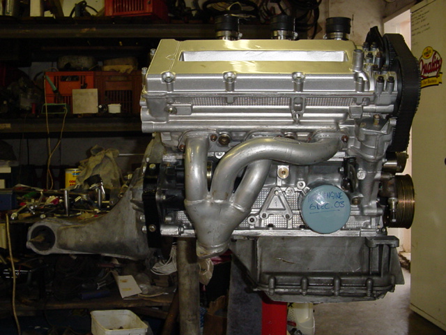

A variation on Murray`s stand,same basic stand,but very Alfa specific..

Yes Barry the "variation" is primarily that which is hanging out off the end of the engine stand :evil: My 2.5 would probably serve as a good starter motor on yours.
No I don't have Skype - should I ?
Currently I have both a Nord and a 2.5 v6 hangin on the reaf flange in one of those engine stands with four arms.
Seems to me that the person that designed that stand usually plays around with big blocked engines as you really need to play around with those arms to get it to fit. :roll:

I posted my stand as I bolt the engine on sideways using engine mounting bolts...

Only problem I have with the rear flange mount like Mats is that the flywheel ,seal and bellhousing has to be ass off the stand.
This engine is on the stand here,but the other side manifold does not fit,so I still have to ass. the manifold off the stand..
Rather a manifold than flywheel,somehow i need to hold the crank to torque the flywheel bolts..
I used a rear flange stand from Harbor Freight. Cheap piece of cr*p, but after some welding, it worked great. Bought some 11+ hardness metric bolts at local hardware. The thing is, you need to put on and take off the bell housing while engine on crane. Also, get a four wheel engine stand, much better balance....and therefore safety. Finally, don't trust the stand to hold the engine. Always put a jacked block underneath to support the engine when not turning it ( and remember, when turning, these are top heavy) You can get a floor jack in easily under the engine on the U-shaped four wheel stand.
I know you can't see everything in the photo, but trust me, it's there!
