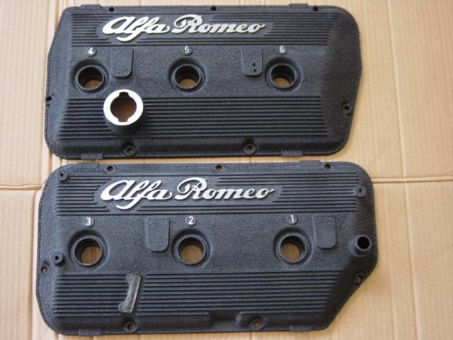

. Tappet covers and plenum will be coated with VHT wrinkle black.

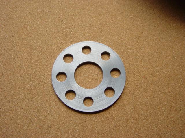

. 4mm flywheel spacer for the 2.5 flywheel

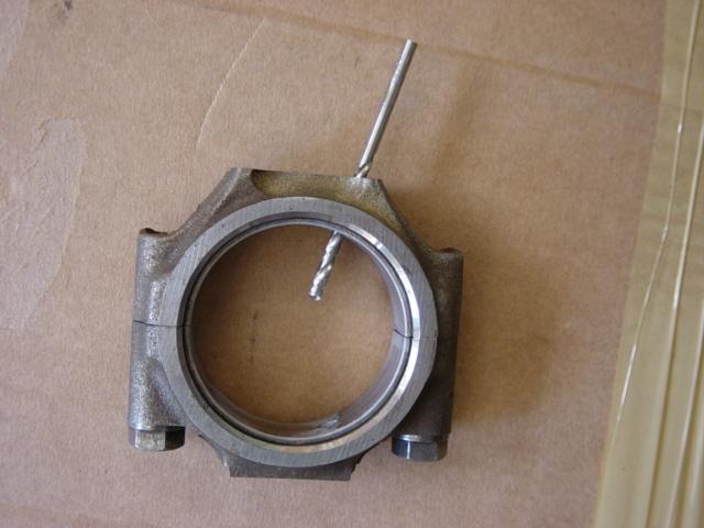

1. Genuine Alfa big end bearings are no longer drilled for the the oil squirters on the con rods. Drilling is no problem as I've made a jig to do this. Should I drill these or not?

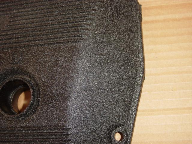

- Cam covers in VHT black wrinkle
- DSC03944 (Small).JPG (50.6 KiB) Viewed 18685 times
- Close up of wrinkle finish
- DSC03942 (Small).JPG (72.18 KiB) Viewed 18685 times
- Jig for drilling big end bearings
- DSC03948 (Small).JPG (37.82 KiB) Viewed 18684 times

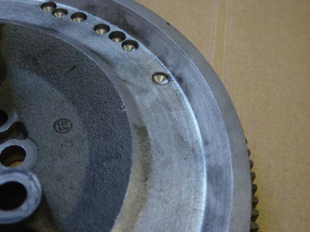

- 2.5 flywheel lightened and balanced
- DSC03951 (Small).JPG (40.89 KiB) Viewed 18683 times
- Flywheel spacer
- DSC03933 (Small).JPG (55.15 KiB) Viewed 18684 times

Seb, The flywheel, crankshaft, front pulley, etc were balanced as a complete unit.

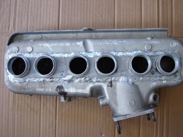

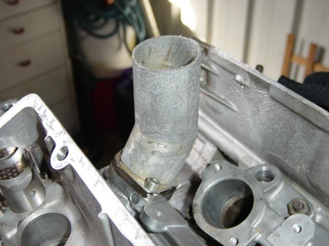

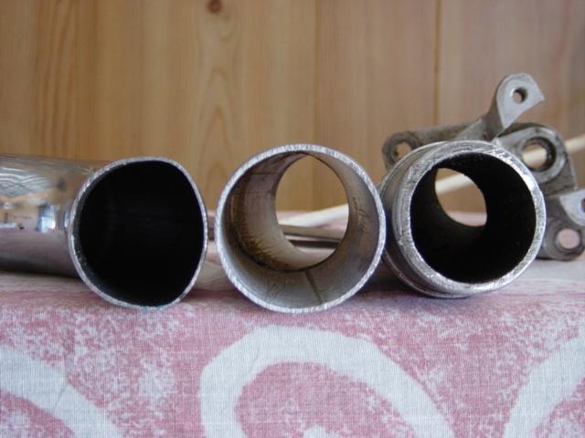

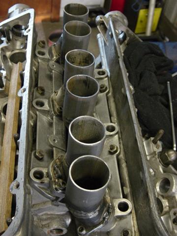

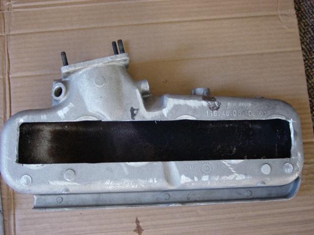

Plenum & Runners
I decided to go with the 2.5 plenum again as it makes the intake, throttle body, etc a lot easier. After a bit of hacksawing on the 164 plenum and the 2.5 plenum I had the 164 inlets welded to the 2.5 plenum. The 164 inlets have been reamed out to around 41mm.
Instead of mandrel bending the runners I did a cut and weld to acheive the required bend. the plenum and runners will be joined with silicone hose.
A cross section cut of the original 164 runners shows they are not much bigger than the 2.5 runners.
Pics of progress so far.
David
David
- 2.5 plennum with 164 inlets welded in. Reaming still to be finished.
- DSC03975 (Small).JPG (45.73 KiB) Viewed 18332 times
- 2.5 plenum with inlets removed.
- DSC03958 (Small).JPG (40.09 KiB) Viewed 18333 times
- The 164 plenum cut up.
- DSC03954 (Small).JPG (39.45 KiB) Viewed 18333 times
Runners
Runners
- Tacked in place.
- DSC03979 (Small).JPG (37.83 KiB) Viewed 18330 times
- DSC03965 (Small).JPG (44.24 KiB) Viewed 18331 times
- 164 runner on the left, new in the middle and 2.5 on the right.
- DSC03971 (Small).JPG (42.29 KiB) Viewed 18333 times
