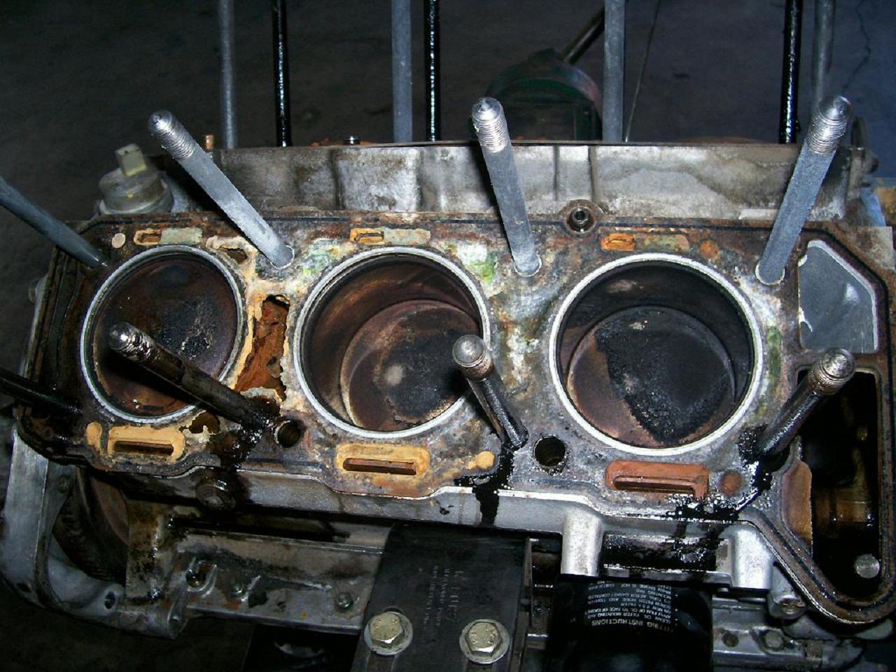

- Extensive rust damages on RH bank sleeves
- 100_0215.JPG (176.62 KiB) Viewed 11749 times

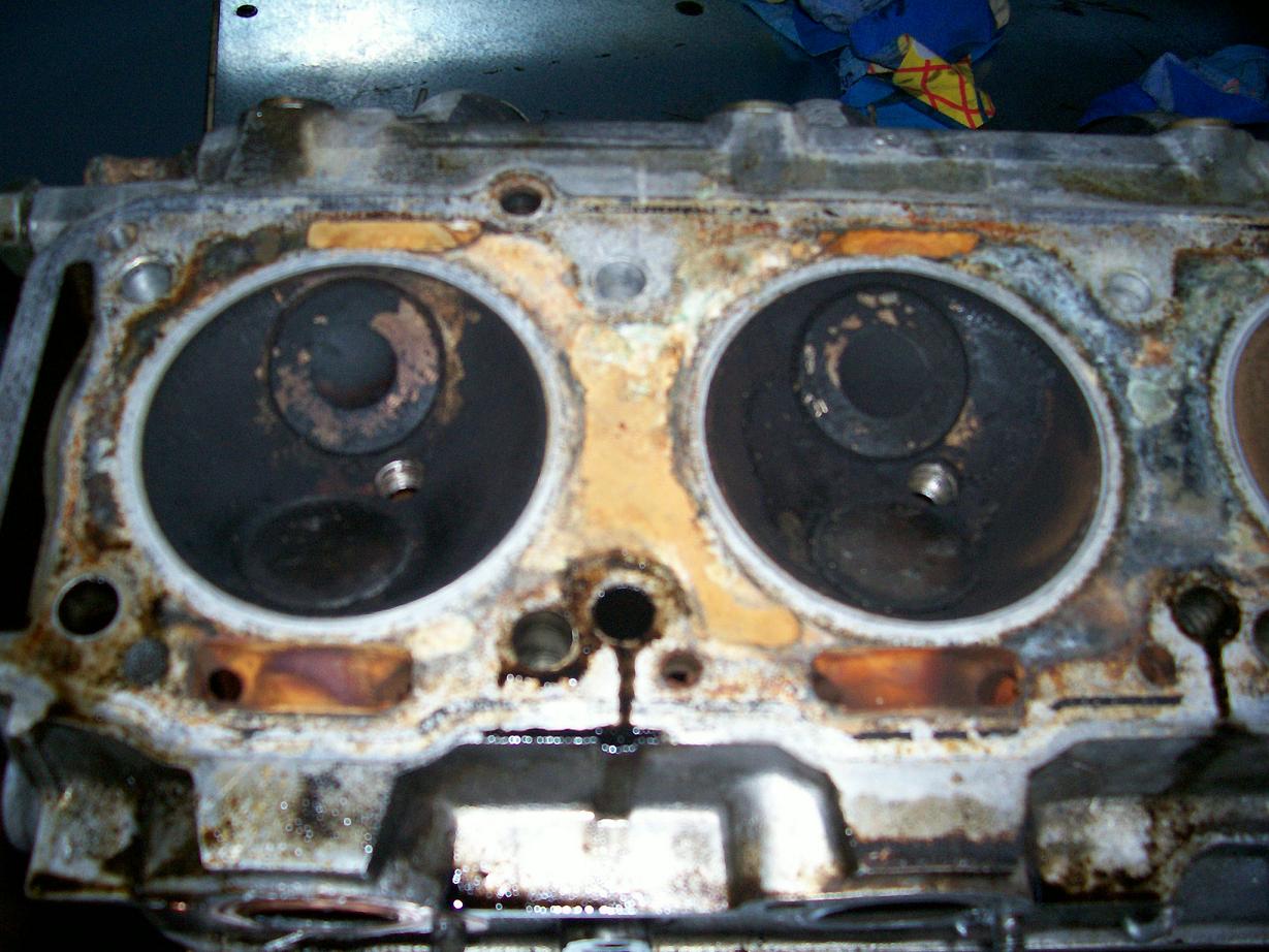

- RH head, 2th cylinder intake valve might be bent???
- 100_0207.JPG (202.84 KiB) Viewed 11749 times

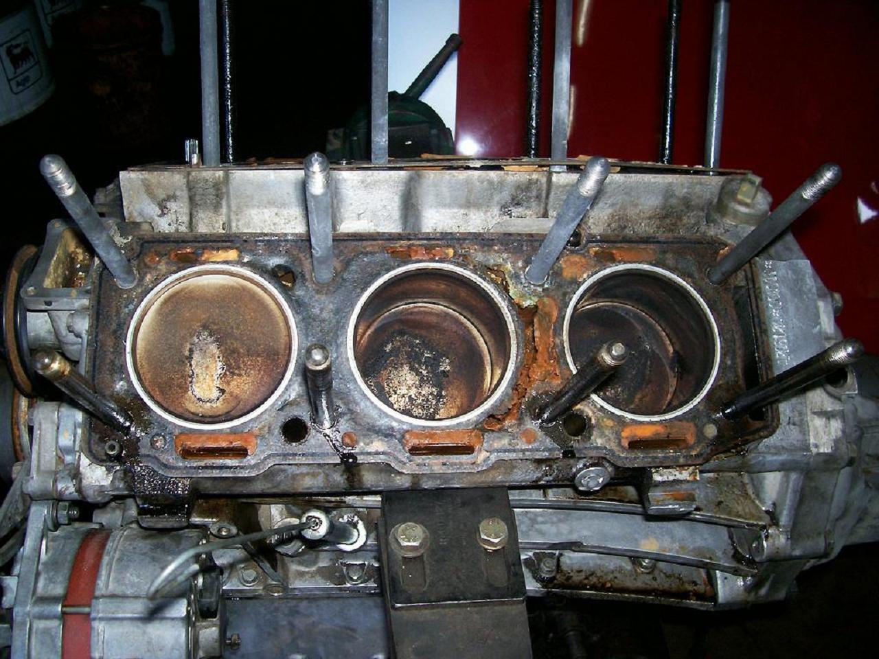

- LH bank
- 100_0204.JPG (199.09 KiB) Viewed 11749 times

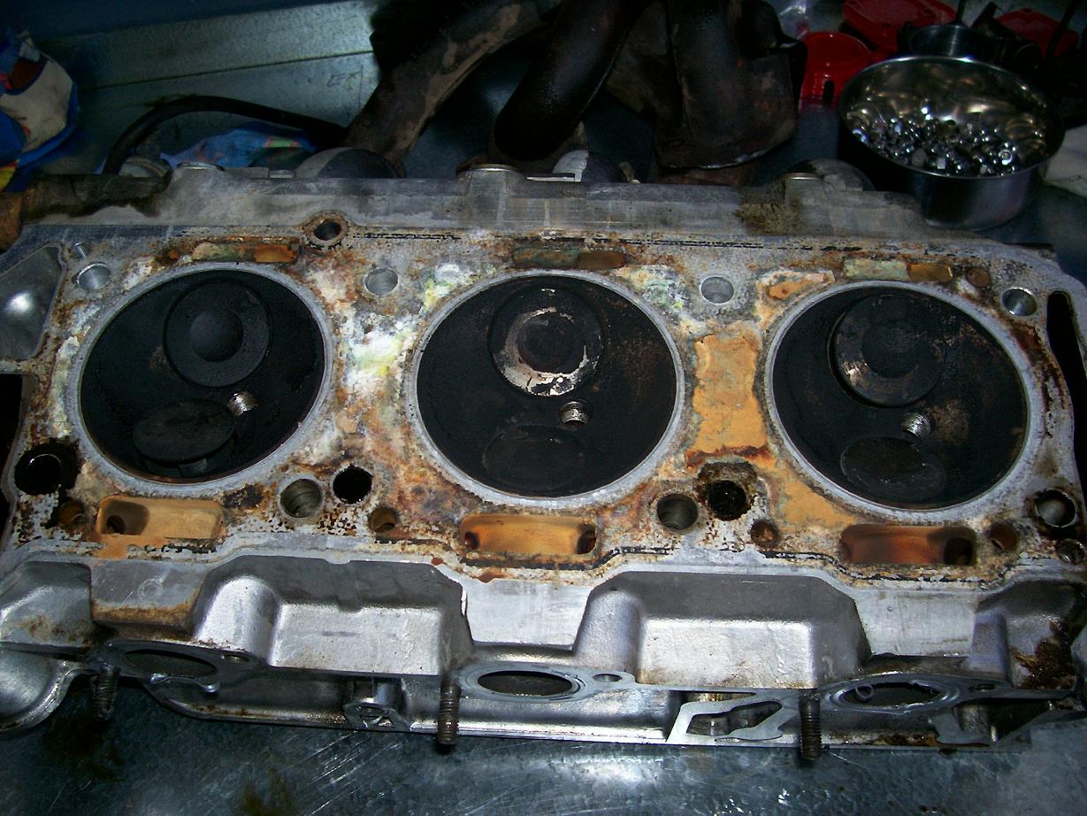

- RH bank
- 100_0203.JPG (202.47 KiB) Viewed 11749 times

Gees...I have never seen such orrosion in the water jacket before,not even in real old 4 cyl engines..
All is not lost though..the sleeves look good visually.If they are,pull the pistons and measure..Dont pull the sleeves from the block yet.
Id use caustic or hydrochloric to clean the rust out..carefull,not too long with all the ally...This process might also open up corrosive holes under the sleeves though... pull them now that all is clean and redo seals...
A block that is corroded under the sleeves can be sorted out by welding or ,if not bad,good ol grey silicon sealer ..I know a lot of people hate silicon sealer..I have no qualms about using it..
Put the plugs back in the head and fill the chambers with a liquid of some sorts..Id just use some petrol..see if the valves are REALY bent..I dont see marks indicating bent valves,but then again it realy does not take a big knock to bend a valve..
Take from there...Is it viable to repair or dump...
Btw,I have 6 intakes bent on a new 30l engine I did for a mate of mine...foreign object got into the timing belt..bugger...
