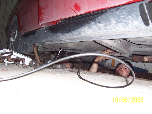

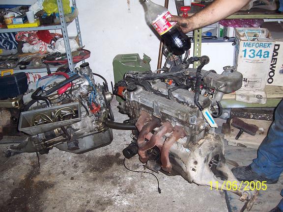

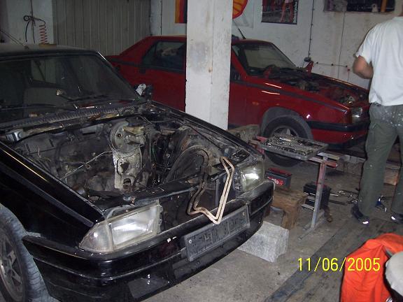

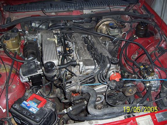

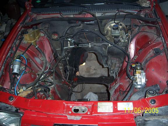

Post by sira »
I made similar engine swap in my Alfa 75, swaped 1.6 carb with 2.0 TS, the fuel needs a return line and the tank with return line. Line to the engine is OK for 3.2 Bar fuel pump.
OK, I am running out of patience with endless engine issues on my GTV 2.0. Reading the board here, it seems like the 8V twin spark from an Alfa 75 is a straight drop-in for my 2 litre GTV (1984, 116 series).
(a) is that correct - do the flywheel, bell housing and mounts mate up correctly?
On Alfa 75 everything mate up correctly
(b) what else is involved? If I buy a complete TS with computer, intake and exhaust manifold, is it just a matter of mounting the computer, swapping the fuel lines over, mating up the exhaust, connecting up the cooling system and the electrics?
Best option is if you have whole rusty TS Milano, becouse you need Engine with all sensors(crank position, MAP, O2 sensor) , ECU, Wiring Harness, headers, you must make Fuel pump carrier, make whole in firewall for wiring harness
Few pictures from my swap:
