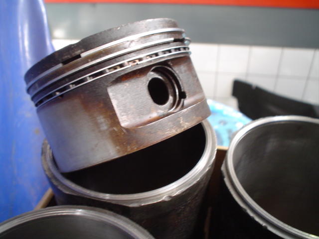

86mm bored sleeves for a light pressure turbo...
Dobri 211.jpg (136.54 KiB) Viewed 20694 times
TS_turbo
Posts: 185
Location: Bulgaria
Post by TS_turbo »
great Barry :!: looks like bmw or opel piston ? my friend run 85mm nissan pistons on his 2.0 TS turbo 1 bar boost 1.2 overboost 10 000 km without problems :)
:D Yes,Opel 16v piston!
Nice spotting there D..Any detonation will split it though,so creep up on max tuning gently....
This particular engine is now breaking std GTV6 twin clutches..I told the guy to keep boost low..Ya,sure he says.. :D
