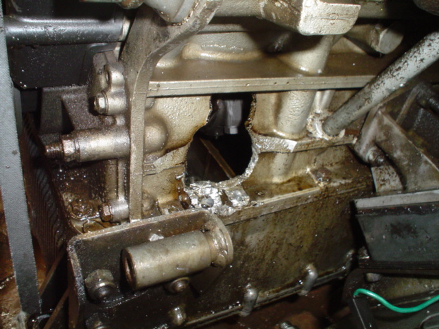

:D My motor finally died on me this week-Its been making this funny noise for a while now,but it suddenly stopped working.
I found this funny thing in the hole in the engine.

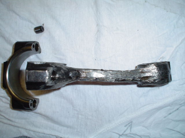

:mrgreen: Seriously,I have broken and destroyed my share of engines in my time, but this is the first time I have removed a conrod from the hole in the block with the engine still in the car.and the heads still attached.
That sucks. Rod bolt failure?
Andrew,Its pretty buggered.Scrap worth. Good stuff,we see you soon then?
I removed the plug to check on the piston-its still in the sleeve!!Top looks good(boroscope) Never say the Alfa`s rods are weak.

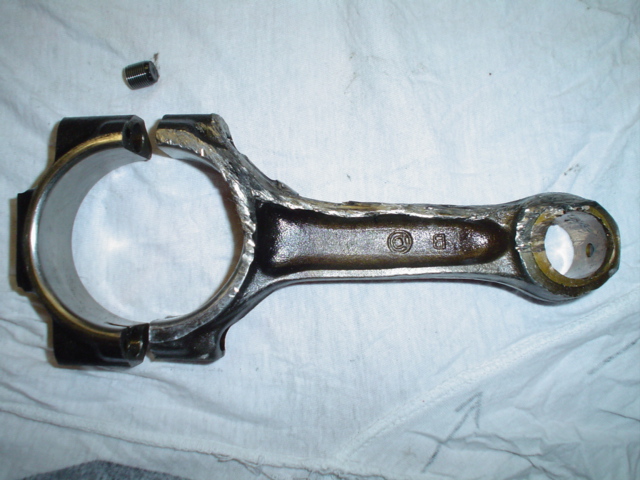

As I said ,this motor has been giving notice for a while now.It used its fair share of oil and has not been happy up at 7000 rpm plus.I actually started hearing what sounded like a valve seat that had come loose in the head (A LOUD "CLACK" NOISE) Putting it down to something like this i drove a further 157km before it terminally expired. At one stage it actually went totally quiet but emmediatly developed a severe vibration.This was when the rod let go and we were on 5 pistons only.The oil consumption went up a bit due to the hole in the block.If it were not for the hole ,I reckon I would have made it home-a further 7 km`s....

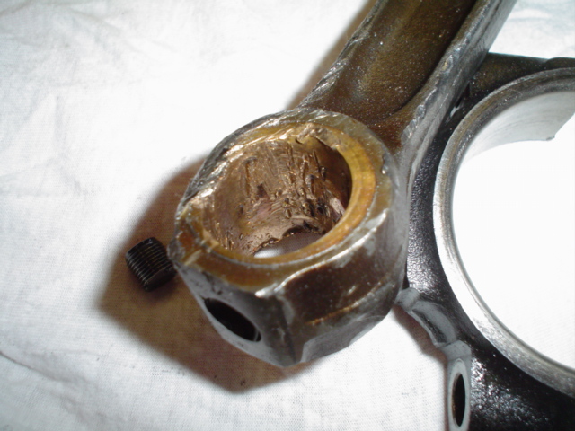

Now if you look at the small end,I reckon the gudgoen pin let go...The piston is in one piece and still in the bore..First time for me......

You know.I said the rods are strong but it could just as easily snapped .It just did not do so this time-I actually treated this engine badly,it was saveable had I not carried on.
