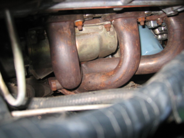

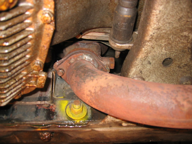

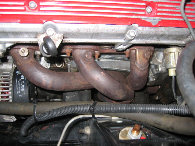

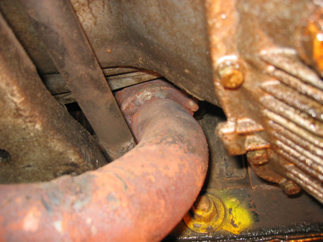

You can use the 164 headers in the 116 conversion but you need to do some heating and bending. The negatives are you have remove engine or shift over to one side of the bay to remove the headers. check out the following pics.
close ups
Other side
Under side. left. Some very tight bends. Best you do these on the engine stand.
Under side right.
Kev,Pics of the INSIDE of the pipe? :D
Ha Ha. I can send you one now. Take you a while to figure it out. No flash needed. Dont want singe anything.
