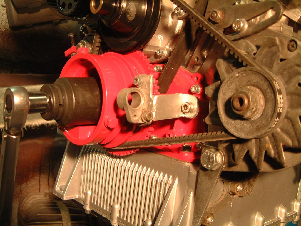

Zamani: Yes I have a sylinder reference trigger. Its mounted behind left camgear. I have welded a bolt into the camgear and the bolt passes the sensor when syl 1 is at TDC.
Jarle
Jarle
Posts: 88
Location: Norway
Post by Jarle »
Bad position, but I think you seen how it works.
Jarle
Syl reference1.JPG (97.31 KiB) Viewed 15876 times
Ah ok Jarle that looks good!
I thought the dissy was a simple method so I used that instead.
Actually, I think SMC 1.92 can accept 60-2. So you can just use an SZ or 75 3.0 Motronic crank pulley and crank angle sensor.
Jarle
