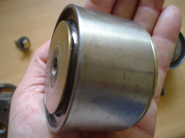

VW Golf wheel bearing,double thrust,so it very good-part number-633296A.
Works as a main 24v bearing AND tensioner bearing.You need to machine up the plug that goes into the center of course.
On the tensioner use 2 std. tensioner bearing plugs,have them ground untill they both fit from opposite sides ,allign and use.

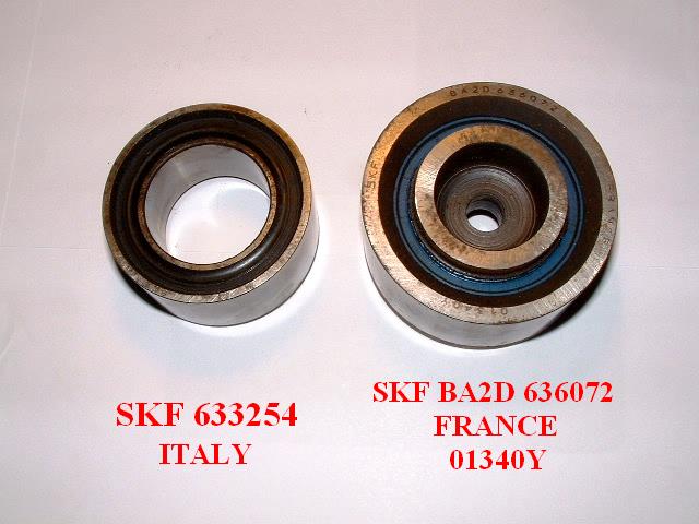

Michael -
Tensioner bearing - 633254
Idlers - 2 x 636072
Both SKF numbers.
Barry -
I thought the idler was bigger than the tensioner, does the tensioner have enough adjustment to take this up ?
Borrowed from another site, thanks
24V timing belt bearings.jpg (42.63 KiB) Viewed 6155 times
Dan,so it is...I have had no problems with the bigger dia. bearings I use.As you can see from the pic,this one has been on my engine for ages already.

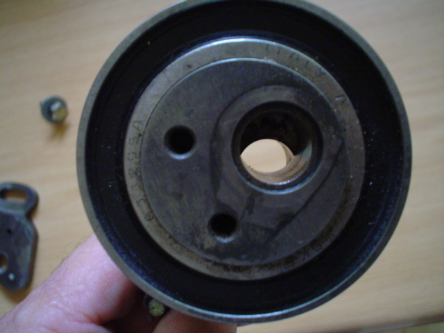

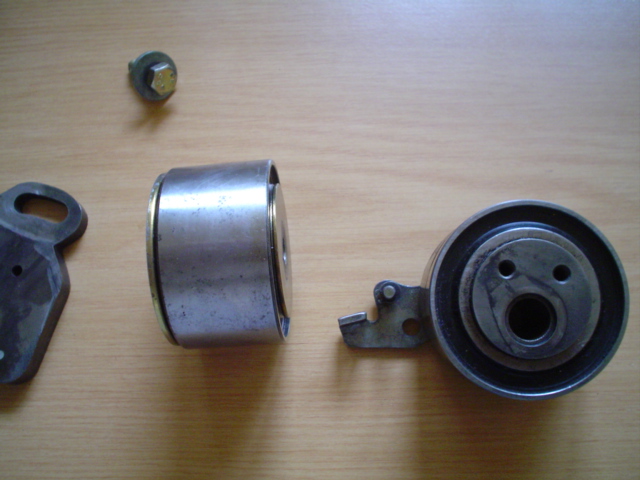

Ok, I ended up buying the tensioner bearing and machining up my own idlers that take 2 x 6203 deep groove ball bearings.
New tensioner and machined idlers
