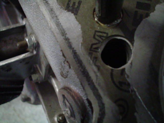

Fred,These 2 holes are for the stud and for the drain back hole for the oil...
Ive had this problem on a few motors now,one being Kevins engine a while back..
This gasket had silicon on from a previous assembler,ignore the silicon..

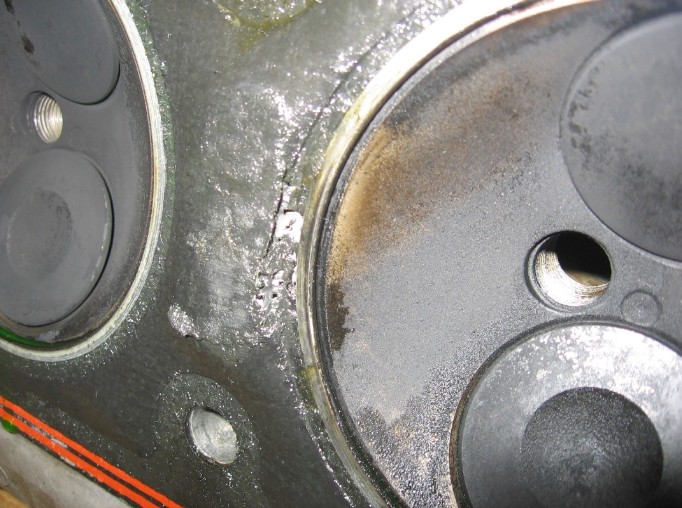

Heads are now off and nothing is wrong. Gaskets are perfect, combustion chamber, drain oil holes as well.
How could i test the proofness of the head ?
Have you measured the sleeve protrusion yet?
How old are the heads? although I must say Ive not yet had a 24v head with cracks..
Just thought of another possibility..Water seeping from under the head nuts and washers into the cam covers..That Ive had before..It comes up from the block next to the studs..
Can you post a pic of the gasket surface,head side??
Waht are you torquing the head nuts to?
Are you using Alfa`s recommendations of 20,40,55 and then some degrees??
I pull them up with a good old torque wrench to 88nm....
