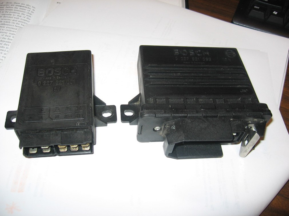

when you changed the ECU did you also change the coil controler (advance unit)? it is the small box somewhere next to the ECU.
guessing that you have a Milano wiring setup.

sly: I know the box you are writing about..I just can't find it Someone else put the harness in before I got the car. ..I do have a spare in case I do find it...
Tahnks guys...it is probably some loose wire somewhere and may indeed have to do with the spark box.
Interestingly, My wiring harness is a combination of 3.0/Milano and 2.5/GTV6 technology. I have the 2.5 spark control and fuse box, 3.0 computer, and a few jumpers and splices here and there to make it all work..(It came to me like this...)
My problem is that I have only one 2.5 spark box and at least three 3.0/Milano spark boxes, so no way to test another box....
I have Milano harness and fusebox, but no way do I feel like replacing everything..
Soooooo....ANYONE INTERESTED IN A TRADE?? I will pay shipping
Left: 2.5GTV6  Right: Milano<br />Spark control boxes...
