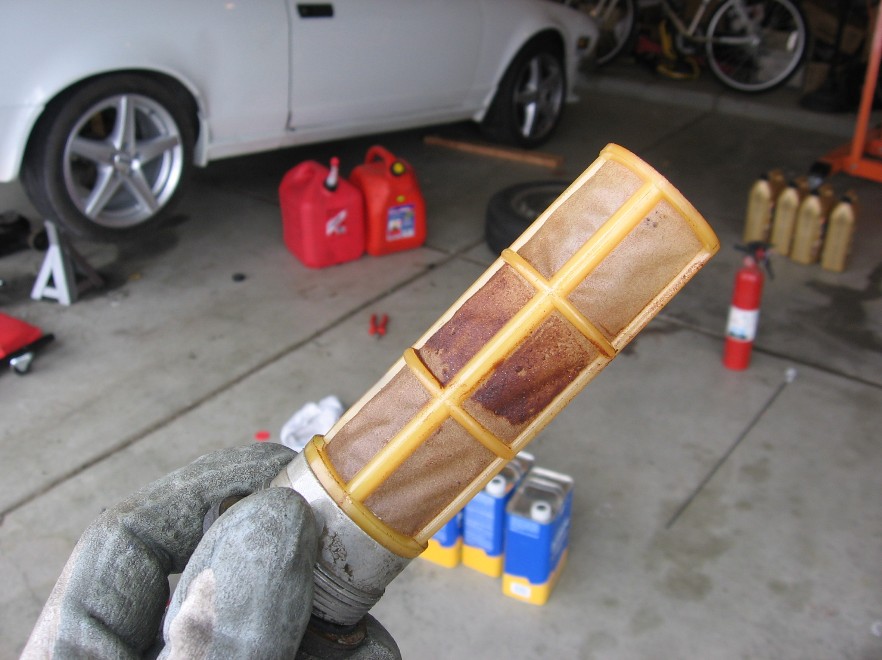

At least for the 1985 model year, there is a nylon mesh filter in the tank. doing a real thorough net search, I found that many other Alfa years also have in-tank filters and there are many people with my same problem.....
If you have not cleaned this out and you have hesitation, I posted some pics on how to do it. I really did not feel like resealing the tank and stripping everything out of the inside since only about 1 inch on the bottom had very light rust...but enough particles came out to clog everything!!

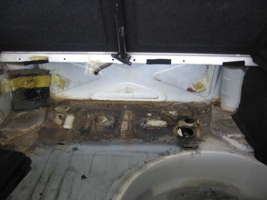

SO. before doing anything...get a fire extinguisher ready and remove the battery (remove it so that you don't accidentally short the tank on it when taking the tank out of the trunk).

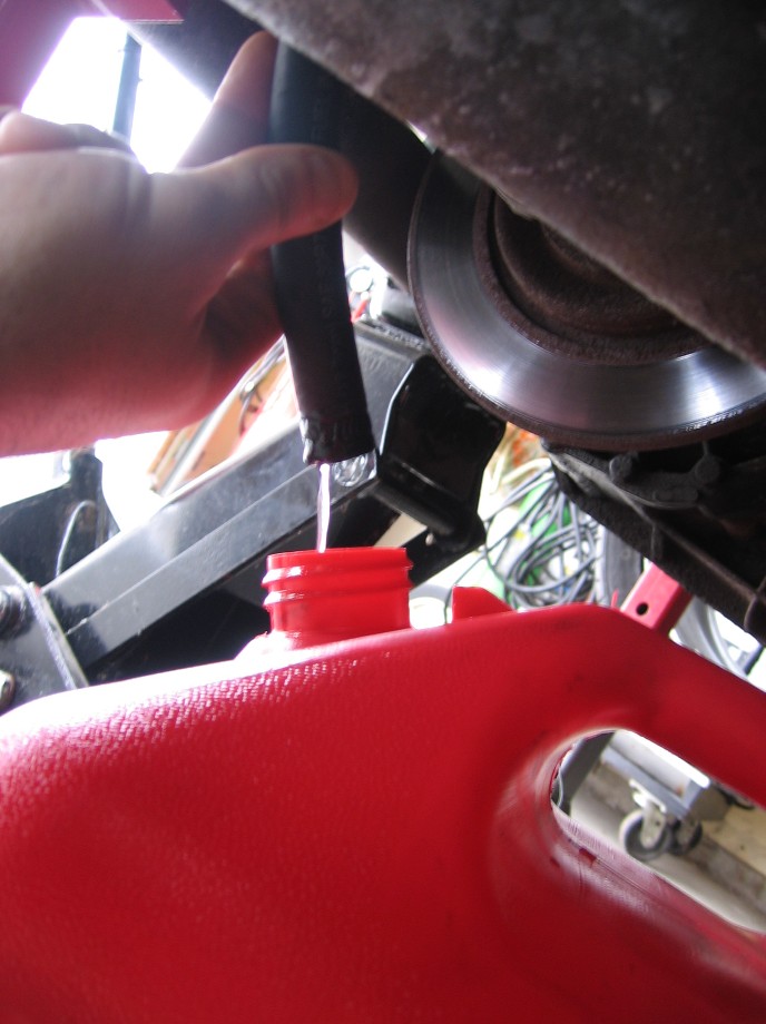

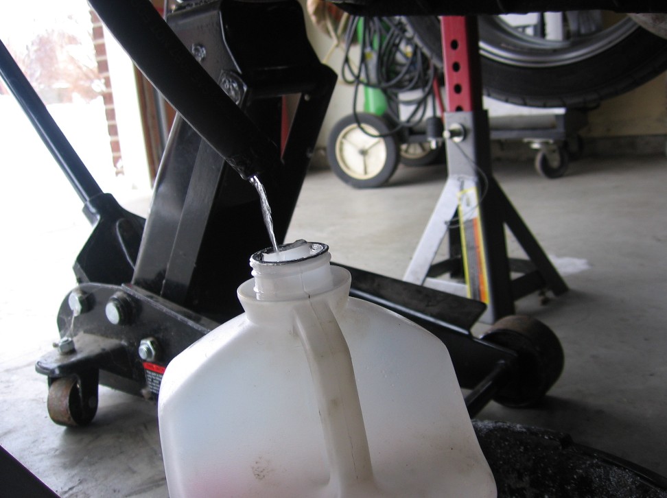

I drained out the gas through the tank outlet hose so that it was filtered (about 10 gallons in my case...and I only kept this gas after confirming that the IN tank filter was indeed still intact).
undo the charcoal and filler hose clamps, undo the wiring, undo the band clamps (which jusdt unhook when loose enough)
jack up the car and support well.

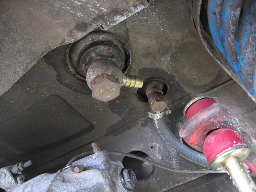

you can leave the hoses attached to the banjo's under the tank. Just remove the Banjo bolt to the return fitting (the smaller one)...and then remove the drain banjo bolt. With some effort, you can gently pry the tank out. When you get it out far enough, undo the breather clamp (on in reverse in my case)

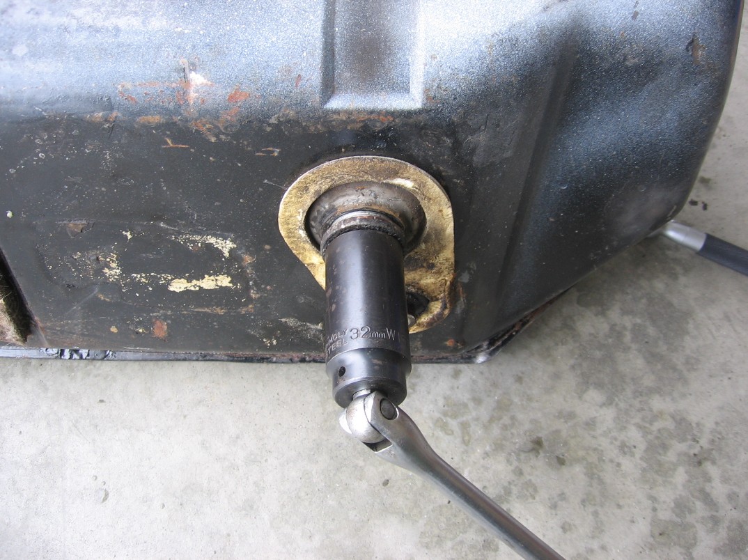

I left the 32 mm nut in the bottom of the drain outlet because it was hard to undo under the car. Once the tank was out, I had more leverage and off it came. This 32mm nut was attached to the nylon in tank filter.

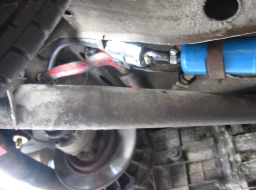

I decided to cut off the in tank filter and replace with an external 1/2 inch filter from NAPA auto parts. This will be easier to change in the future.
So now take that empty tank and fill it with a gallon of acetone. swish and drain. then repeat. this really cleaned the metal. Some rust remained but it was very minimal. I hooke up my shop vac in reverse to push air through tank for 2 hours. This really dried everything out...because you don't want acetone in the fuel system!! If it was warmer out, I might have washed tank out with water and then the shop vac thing... YOU SHOULD SEE THE PICS OF THE FINE RUST CLOGGING UP EVERYTHING

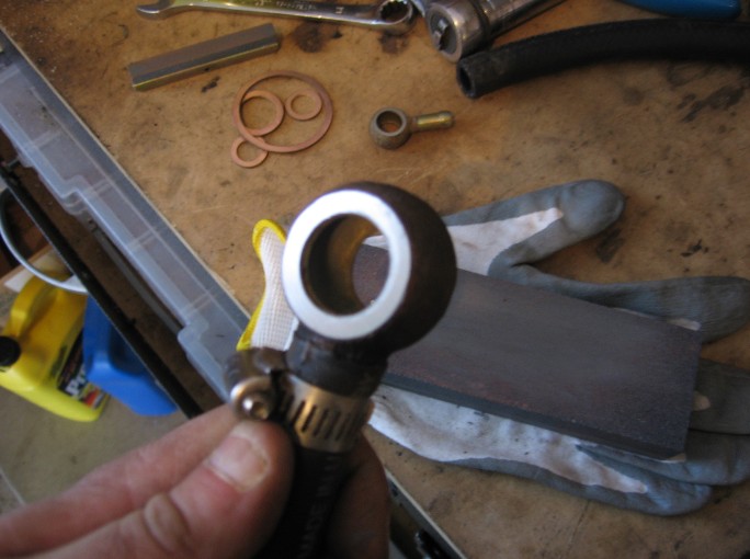

Installation is the reverse of above...BUT i gently filed flat the old copper washers for the banjo bolts and resealed these fittings with a fuel proof sealant (brown stuff from NAPA)
final step was to install new external filter..see pics.

- at other end of 32mm nut, with some dirt
- IMG_2895.JPG (111.93 KiB) Viewed 11625 times
- 32mm nut
- IMG_2893.JPG (234.18 KiB) Viewed 11626 times

- new out of tank pre pump filter
- IMG_2901.JPG (89.88 KiB) Viewed 11622 times
- reinstalled banjo's
- IMG_2899.JPG (142.64 KiB) Viewed 11623 times

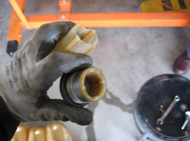

- I cut off the in-tank filter and smoothed the edges. I left some of the plastic in the nut because the nut is alloy and I did not want to screw it up...

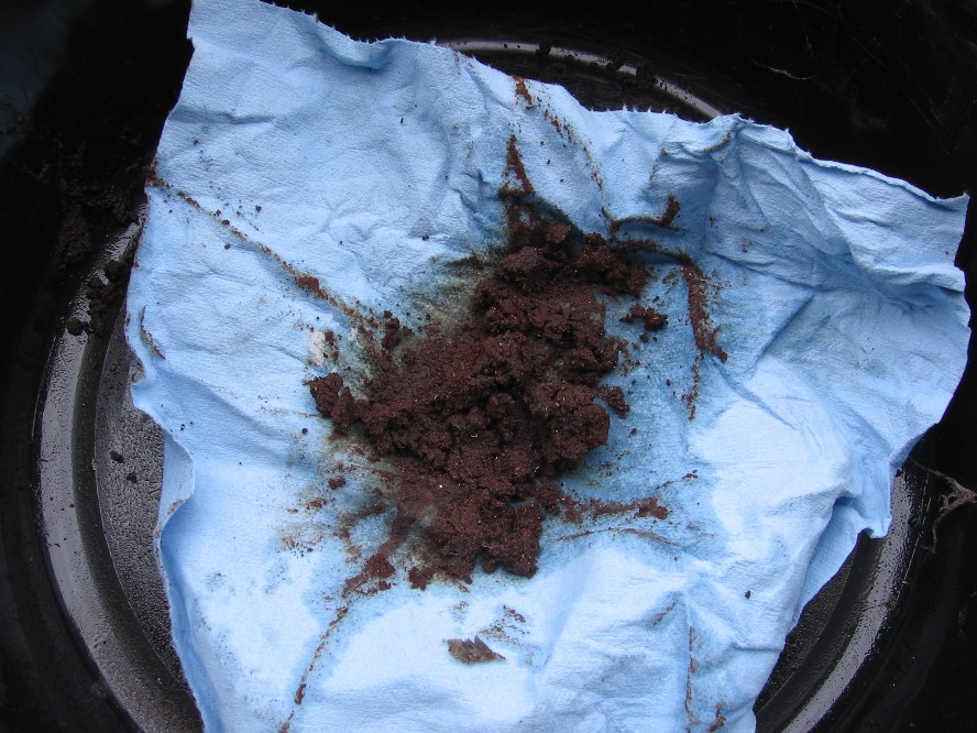

- look at this pile of fine rust crap...three more full ass wipes where this came from... No wonder she ran like shit
- IMG_2896.JPG (187.08 KiB) Viewed 11623 times

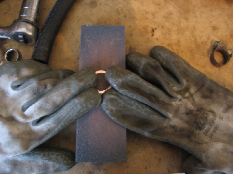

So I drained the tank again. removed it, cleaned off all my sealant and really polished the washers and falttened every mating surface as good as possible.

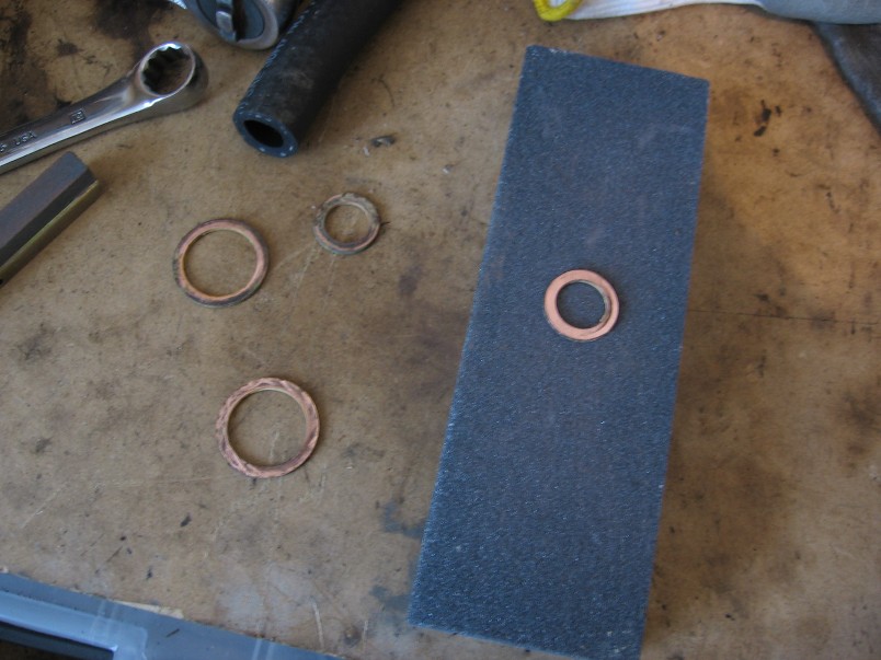

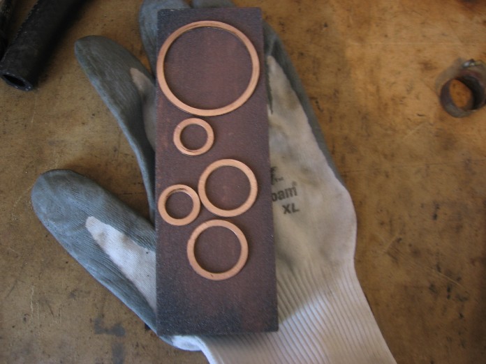

Tips on reclaiming copper washers below using knife honing stone (probably 2-300 grit on one side and 3-400 grit on other) makes washers very flat and shiny...like new.

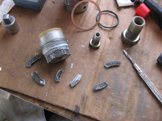

But then on assembly with a little PTFE sealant, I found out what the leak was really from...tiny cracks in the 'in-tank' filter housing sealing rim which just fell right off when i tightened it to the tank. F**K ME!

- bits of the compression rim just fell off , part Fispa 306002
Anybody have a spare?? - IMG_2922.JPG (84.25 KiB) Viewed 11296 times

New nylon filter pops right out and will be saved.
MORE TIPS: I forgot to mention that after smoothing the copper rings on the stone, they have to be annealed. I just use a MAP gas torch and guesstimate ~800C (copper glows red). Don't melt the ring, they are hard to find!!
This allows the copper to move into a semi fluid state in which the crystalline dislocations(from prior compression) can once again line up. In other words, makes it soft again and good for gasket work.
Let it cool down slow, but clean off the oxidation before using with emory cloth. A little TFE or PTFE will seal the rest.

- tank filter.JPG (80.22 KiB) Viewed 11156 times
