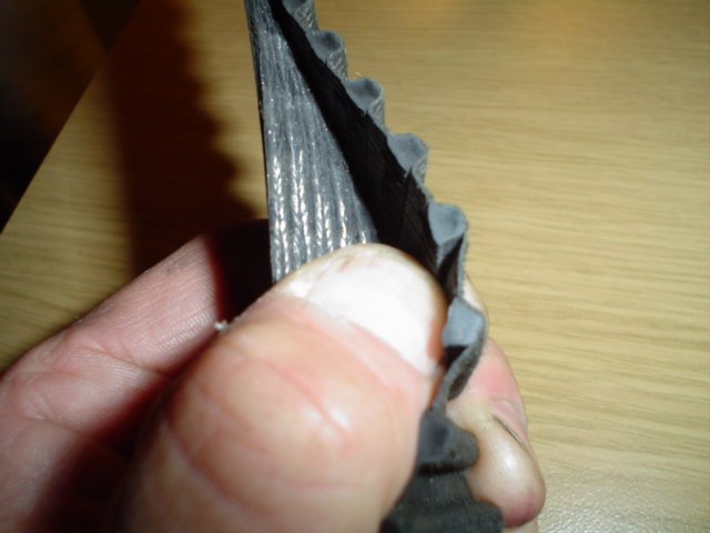

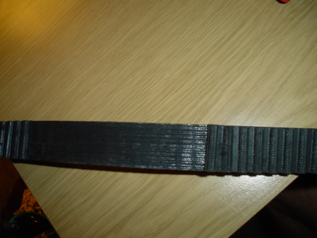

Cambelt 24v -opinons~Barry
Under 10 000km,s
Brand new
Tensions spot on
No foreign objects
No siezed cams,etc..etc..
I have my theory as to why it failed..
Opinions??

All my experience says this belt overheated and then started de laminating..
Dont ask me how but that is my honest opinion.
I checked all the pulleys and tensioner/idler bearings today..All are perfect and like new still.No heat discoloration or marks at all..
Even the cam pulleys are still as in new anodized condition...
I still say its excessive heat.. :!:
