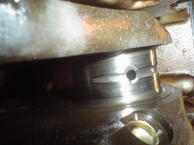

This groove is only on the journal for cyl #4. That is the first rod journal. I will see if I can post a picture later.

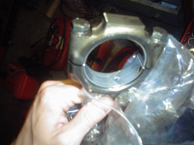

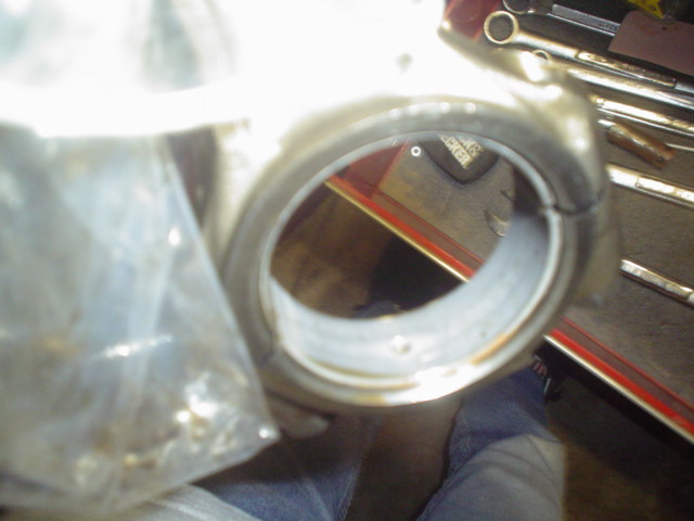

photos....

As you can see (sort of), the bearings for this rod are in good condition. No discoloration to speak of, no obvious wear on the bearings or the journal.
The groove is longer in the counterclockwise direction.
Ermm... I think this issue was brought up before by one of the members a while ago. This groove is from the factory I think.
*smile....*....yea James,its made like that..Thats std. from the factory..dont worry about it..
