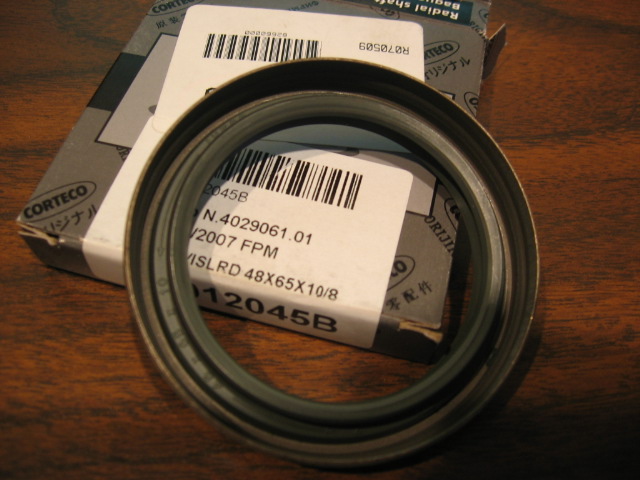

the problem is getting to old one out without scratching the crank or damaging the seal housing with the front cover still on the engine....
the hardest part wil be getting the pulley and crank nut off..once you have done this, you might as well go the rest of the way...you will need a new front cover gasket and some permatex...pan gasket should be OK if your careful and if it's not too old.
It's only a few covers and belts and bolts to do it right and to seat the seal square is much easier done w/cover outside on a bench...
- IMG_2385.JPG (79.63 KiB) Viewed 9409 times
IMO you are complicating matters. How do you then do camshaft seals? Rear main seal? Also, if you should upset the sump gasket it is no fun to try replace upper sump gasket with engine in car. Anyway, each to his own.
Good luck,

x-rad,
Thanks for the foto. What I'll do is to get the front cover gasket and seal then make the decision when I get in there. Ironic, I just had to do the water pump & timing belt due to the leak. I didn't have the luxury of taking the time to do this seal issue as the GTV6 is the only runner where I am.
Also, the motor was rebuilt a few years ago w/15k on the motor since. I'm trying to save up for my 3.0 build up.

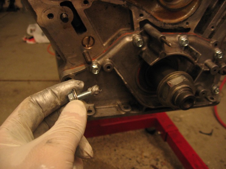

X-rad, It was a hypothetical question to you: How would you do the camshaft seals and rear crank seal? In case the question still doesn't make sense: Very similar to the front crank seal, but you cannot take a "cover" to the bench. Anyway, whatever floats your boat, I just think it is less work leaving the front cover on engine.x-rad wrote:ar4me??? the leak is only at the front main....
sheet metal screw straight into the seal and pull it right off.x-rad wrote:Brooks: Trust me...trying to get that seal out with the crank in place will be very difficult. But evaluate the choice when you have the parts sounds like a good idea.
Sometime it's hard to get them out even when on a bench (see my seal post in engine tear down)
ar4me: OK..hypothetically, if I had big enough leaks at all those seals ..i would pull the engine to redo them..
you are right , though, it is less work...if you can get the seal out
Mats: maybe you guys in the East have different seal manufacturers...I have never had one come out really easily...even with the right tools
and there is only a little metal edge to drive a screw into (to avoid the rubber inner lip and to avoid scoring the aluminum housing) but this is a good idea and maybe it will work
