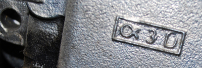

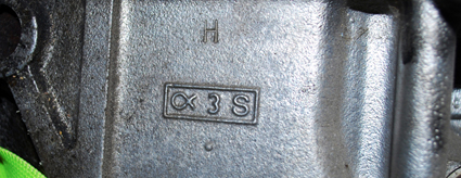

I have this bad boy sitting in my garage, I was told the mileage is lower than 40.000, I inspected the oil sump and removed valve covers, it is absolutely like brand new, does not even have a sludge deposit in it. Anyways, I thought it was a 2.5, but this does not confirm my thoughts, is it a 3.0?? Below, showing respectively the right and left rear banks.

Look under the timing covers on the right (dizzy) side and behind the starter on the side of the block.
also check the block part number at the rear of the block on the left side and report that...I will check mine too.
I think you have a 3.0.

Will do, there was a post on the old forum that covered this, unfortunately there was never a concrete answer I am afraid. So, I will check what you suggested, and in addition if that does not solve the problem, I will pull one of the heads and measure the liner and do some math.

If I remember right the engines ar marked with either 2.5 or 3.0 on the block like i suggested and on the head under the timing cover of the right head and on the firewall end of the leftt head. 2.5 engine part number starts off with 1911 and continues.

Yes AR01911xxxx is for a 75 2.5, but I think GTV6 and Alfa 90 2.5 are different prefixes
