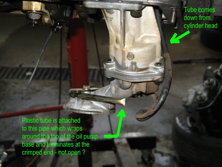

Murray
Posts: 622
Re: Need help identifying weird part
Post by Murray »
Ok guys it's getting stranger :shock: I pulled the sump on this engine today and the attached picture shows where this plastic tube ends up.The weirdest aspect,to me,is that the brass tube that is attached to the oil pump is crimped at its end (and it very much looks to be original AR factory) so it doesn't appear to be any kind of drain from up top ???
Any ideas ?
ALFA TUBE.jpg (78.06 KiB) Viewed 8655 times
xrad
Posts: 516
Location: Canton, Ohio
Post by xrad »
I remember someone else posting pics of this a few years ago...
maybe some kind of oil heating device??
I have seen other pumps with just the metal part...someone probably did head work and removed the hose part...
Strange...
slyalfa
Posts: 88
Location: Milpitas CA
Post by slyalfa »
I do remember it being posted too. but do not remember if any one knew what it was or not.
where does the top go does it just end there on the plastic clip?

Murray
Posts: 622
Post by Murray »
slyalfa the top of the tube is supported by the plastic clip in the cylinder head and it is just hanging there.As Maldi already suggested it is located pretty much under the oil vapour seperator on the valve cover so it's possible that originally the tube was connected to the seperator but it's beyond me what its purpose could be ?
xrad
Posts: 516
Post by xrad »
I am pretty sure this is useless and was quickly discontinued.
But maybe it is called the "OIL PSYCLONE" and can add 5 hp?!?! :P
Possibly a probe went down the pipe to detect oil temp thats why its is closed and suppoerted at pump. This probe could have come through a modified tappet cover . Any sign of that.
