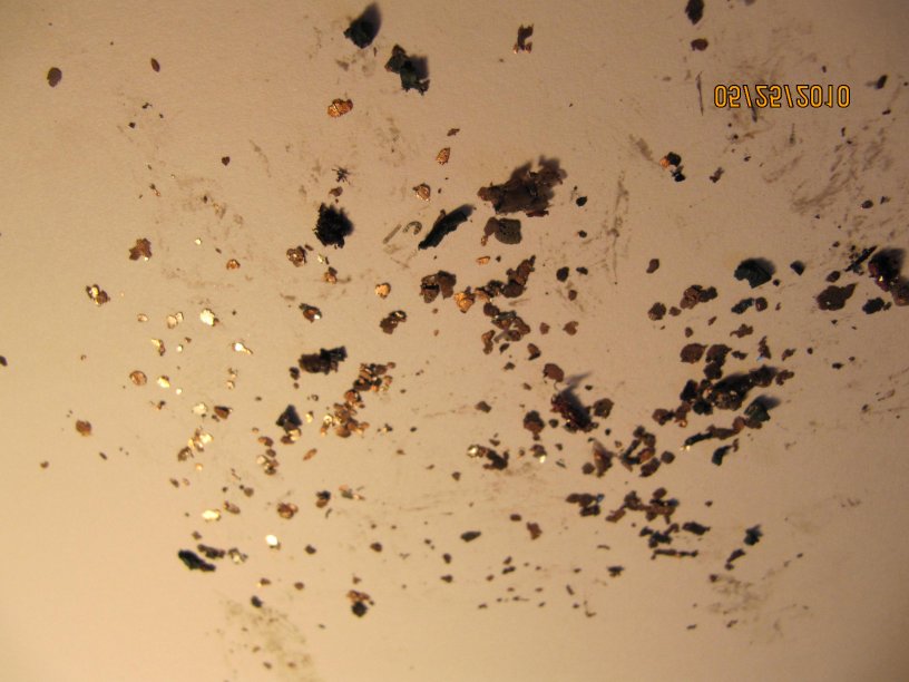

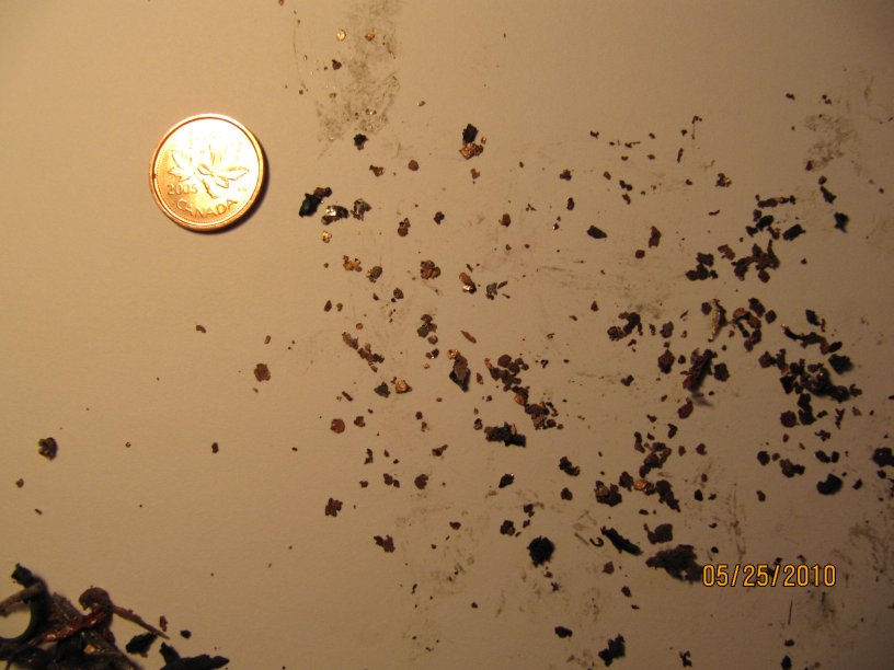

My 1986 GTV6 2.5L has decided to give me grief right at the start of summer :evil: I rebuilt/blueprinted this engine completely about 80k kms (50k miles) ago.Recently it developed a knock when lightly loaded and started sounding "cammy" if that tells you anything.In the hope that my oil pump wasn't up to task (I didn't replace it during the rebuild and don't trust my gauge) I decided to pull the lower pan and swap the pump from another engine.When I saw what was sitting in the bottom of the pan I decided that that wasn't going to be the solution ! I found a bunch of metal debris - most of it is copper colour ? I also found a chunk of a green valve guide seal.I pulled my driver's side valve cover (it's easiest) and expected to find signs of destruction,but all looks normal and there doesn't appear to be any unusual movement in the camshaft up or down or side to side.Tomorrow I'll pull the passenger side.My question for the "detectives" among you is what do you think is the most likely source of these copper-like chunks of material ?

Copper like...hmmm...valve guides?? :roll:

No really , check gear on oil pump drive under distributor. Sometimes on 24v the 10mm nut comes loose and the gear moves up and down then teeth break off which lands in sump and looks just like that apart from the coin :lol:
Engine siezure follows after those teeth go

fedezyl thanks for the suggestion on the guide but I don't think that's it because my guides are bronze and this stuff is truly copper coloured.Strange thing is it's partly ferous because I can pick it up with a magnet.

If I am not mistaken, from oil analysis forums, copper could mean it could be big or small end bearings. That would be consistent with the knock.

Zamani unfortunately your probably in the right ballpark :evil: but I'm still hoping to find something less drastic ! - fat chance eh :cry:

Ugh! My bet is it's the rear main bearing - this happened for who knows what reason on my first rebuild after around 10 or 15K on it :x the only thing I could come with is that the engine had not been started after a numerous months due to "life" getting in the way. GV

Murray
Posts: 622
Re: Engine destroying itself - detectives wanted !
Post by Murray »
Scott yes I found the culprit.It was the big-end rod bearing on cyl no.3 which spun itself.I have myself to blame because it seems I didn't do a very good job of measuring my crank journals when I rebuilt and should have gone with oversize bearings :evil: Fortunately I had a spare 2.5 to put in to save my summer.Lesson learnt on that one too.I failed to turn the engine over sufficiently by hand with oil in the cylinders.It ran for 2 days then got rough.I pulled it and discovered the piston rings had broken on 2 cylinders -no doubt due to extended storage.Well being a true Alfa addict I just happened to have a new set of Borgo pistons/rings/liners and I threw those in and now it screams and pulls like a freight train again - pure joy :D
