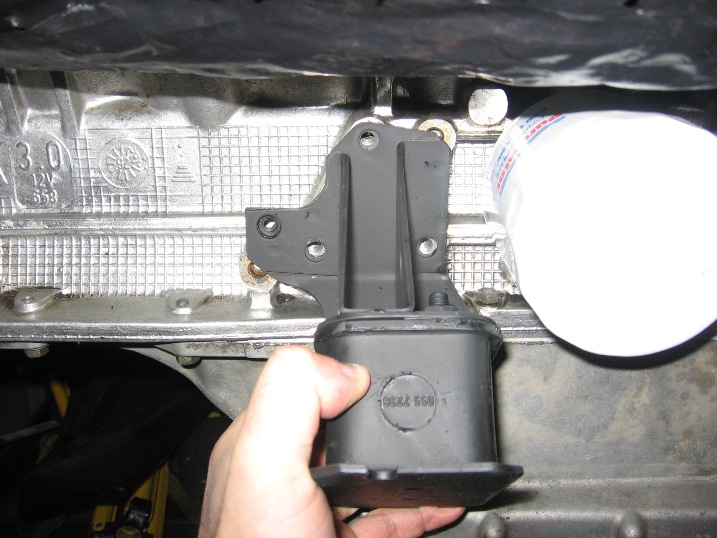

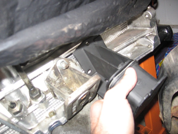

Here are a few pics on the mounts. I know you will use gtv6 mounts, but kinda cool how close they are..
pics of New alfetta mounts against 164 block.
alfetta mount holes line up perfectly( neat since 20yr difference), length is different. So you will obviously need the shorter v6 mounts and rubber blocks. V6 Rubber block pin holes look like they line up to Alfetta body (mine is a 78)
I do not know if V6 dimensions between engine mounts is different than the Alfetta
I might have the mounts backwards, but holes line up either way
