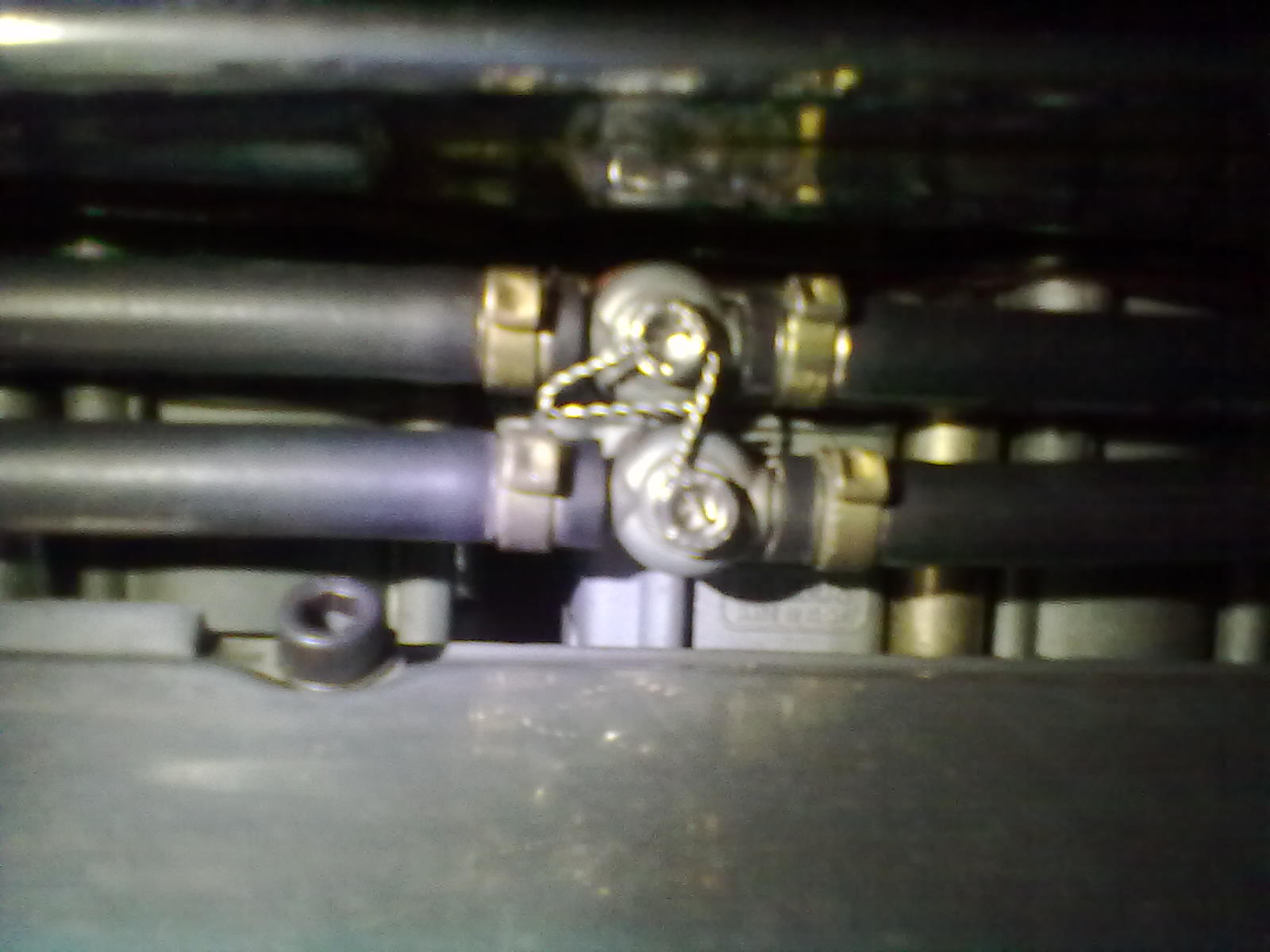

Hey Kevin , saw your post about Konrads race machine and thought I might let you have some pics with regards what I had to do to sort my carbs out properly.
The PO was the second owner , he gave up trying to stop the carbs leaking fuel , after a while every single fuel delivery hose would slowly work its way loose and you would end up having to tweak all the bolts etc. When I got the car I rebuilt the carbs with a kit from eurocarb , but then found when I had them in pieces that a gorilla had stripped out many of the original treads , including pulling the inserts that the filter body cap screws screw in to.
I , in time , removed the carbs again , did some remedial work ! The attachment point for the fuel lines were all drilled and helicoiled with m6x1 coils , I used stainless cap screws and wirelock them as per the pic. No more fuel leaks !
The inserts which the filter body hardware screw into are a m8x0.75 thread , these were carefully drilled and tapped to accept helicoils and the inserts refitted. One small mod here , the accelerator pump nozzle needs to be trimmed / filed down on one side as the helicoil takes up a little space in its hole. ( I need two nozzles as two of mine were found broken when removing them for the rebuild , the little end which holds the gauze filter was still stuck in the carbs , took a couple of hours to get out ! I need to ask Barry if he doesn’t have 2 nozzles for me. The broken ones still work quite well though,no different to the others )
At the coast I found that setting up the carbs to give 25/26 inches of mercury at 900-950 rpm idle resulted in the best driveability and fuel consumption , balancing them as you know requires patience and skill , but when they are good you can leave them be for a long time. At least between valve clearance adjustments.

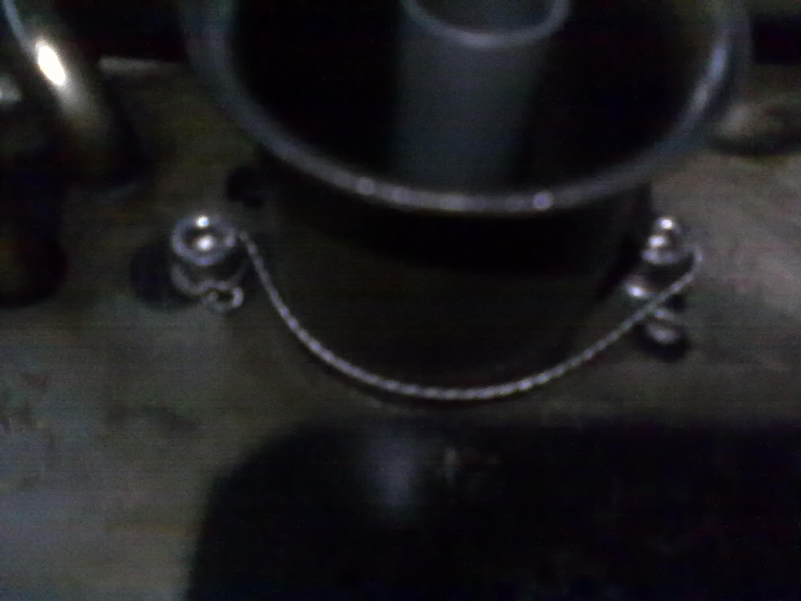

Next pic of wire locking on the cap screws that attach the filter body to the carbs 8)
