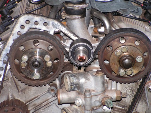

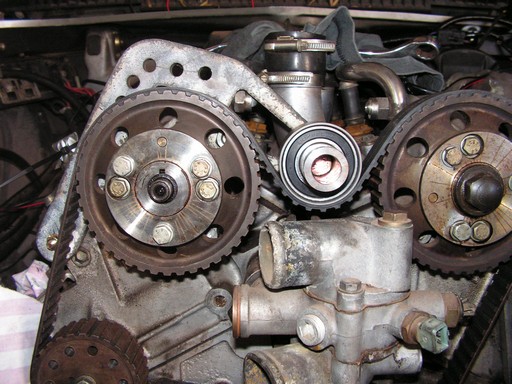

I thought I'd add this here.
I made (I actually stuffed up the shape a bit) a mount to add an extra idler pulley for the 12 valve V6 engines to give the driver's side (right hand drive) cam pulley some much needed extra belt wrap.
The idler is for a Nissan engine and is mounted arse about face 'cause of the mounting sleeve.

What about the belt length?

The new belt is a T034, and is 142 teeth instead of the original's 134.
