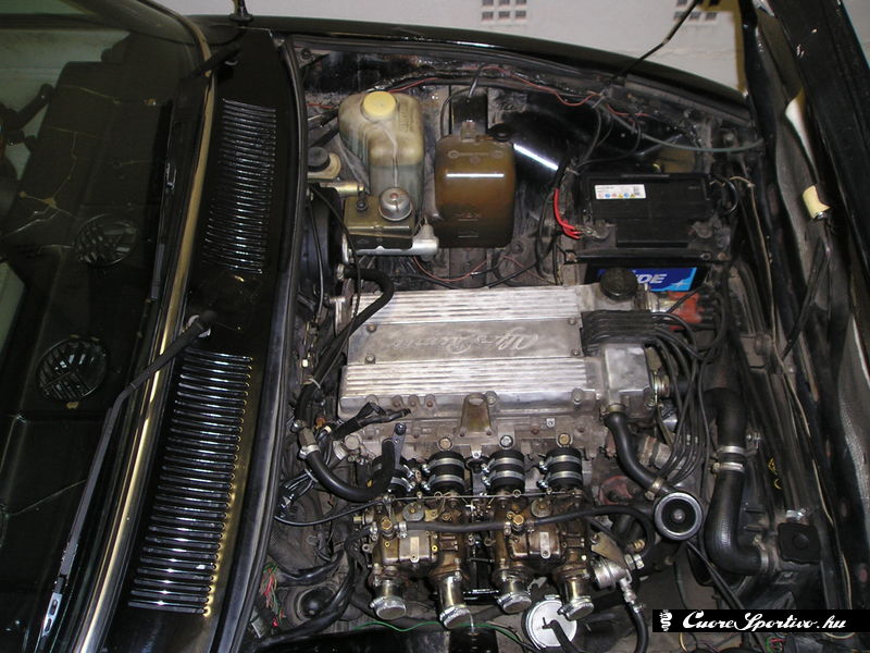

Hi!
i'm Alex from Hungary, and i try to make the same things on my 2.0 TS, but my engine is in an Alfetta from '73
I'll put a new complete exhaust system, and 2 del'ortos on it. Last summer i tried the carburator TS variation and it's very good:)
