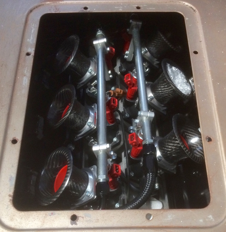

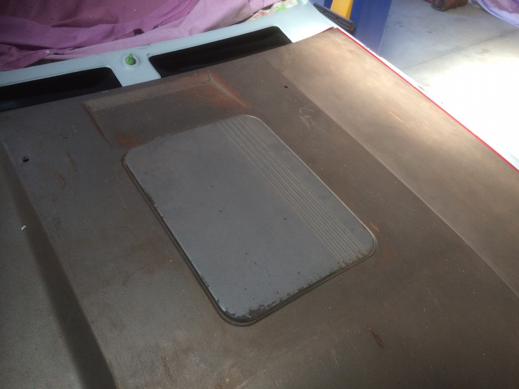

Hi Kevin R,
Just tried the standard V6 bonnet and it fits ,
I only need to change the fitting on the injector rail.
When I purchased the throttle bodies AHM did ask me if they were going on an Alfetta GTV.

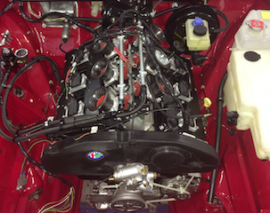

Hi , need a bit of advice .
Got back on my project toy and now starting on the engine.
As I am using AHM Throttle bodies , how would I run the idle with the throttles closed, I really don't want to modify the housings. :?:

Hi to All.
Just thinking leave the throttles open just slightly 1-2 mm and the TPS at zero and the ECU to run the engine @ 650 RPM. :?:

Hi to All.
Got a reply from AHM and they stated to leave the throttles open just slightly.
I just need to make sure that the throttles openings are balanced the same.
