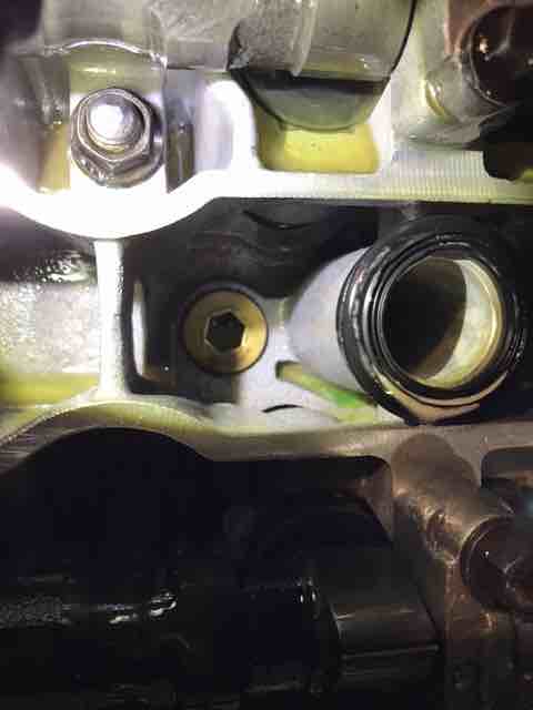

To update everyone, there was still some minor seepage after putting in the k-seal. But nothing as bad as it was originally. I think the brass plugs in the cylinder heads were the cause. There were no copper crush washers and I found coolant in that area.
Putting in some high temp thread sealant and copper crush washers.
