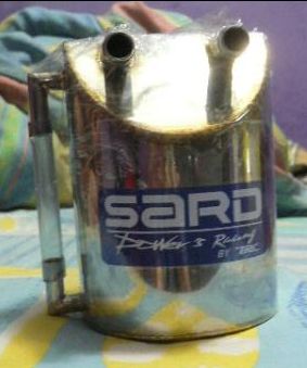

Found this Sard oil collector tank, wonder if it works? Anyone have one of this under their hood....
