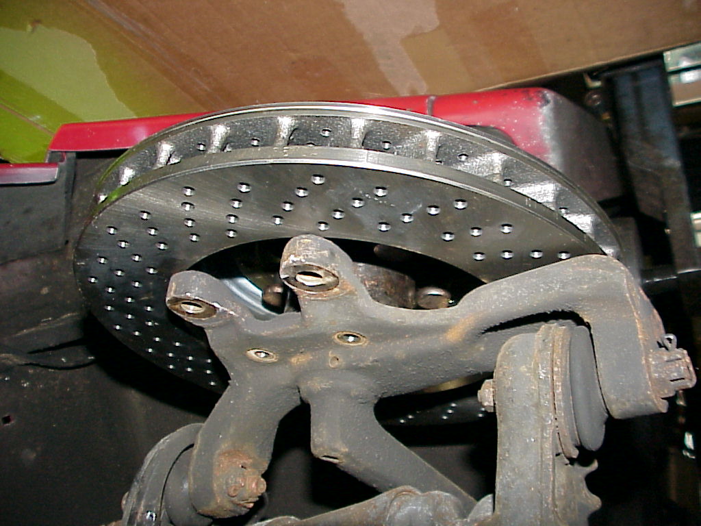

i can show the instalation of my seats right now!
brake upgrade from movit,germany did NOT fit!!
and they are untill now NOT willing to do anything about that.
SO PEOPLE:DON'T USE MOVIT BRAKES!!
- MVC-004X.JPG (196.74 KiB) Viewed 14615 times

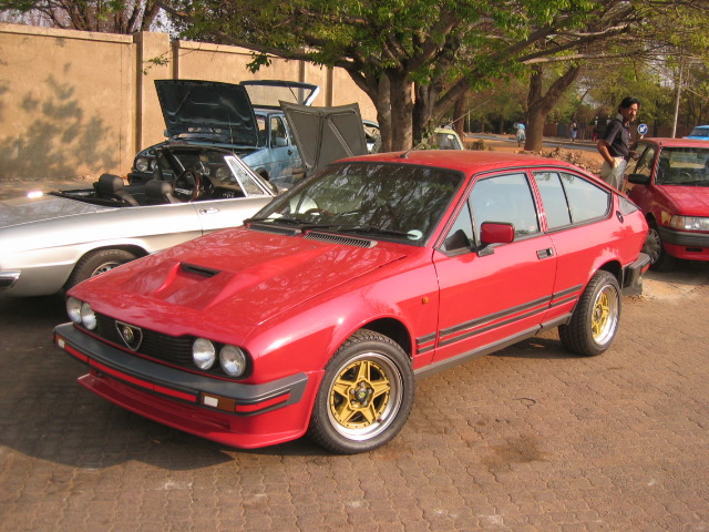

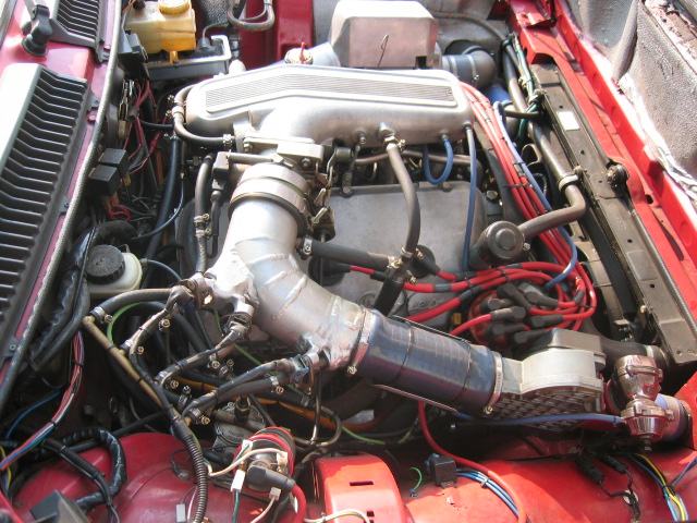

On the subject of interesting stuff with regards to forced induction, check out this baby. Reliability has been good for the past ten years on this car and eats most things alive. Not sure of hp figures but Im sure Barry could tell you as he developed this car.
- Img_1357.jpg (147.82 KiB) Viewed 14002 times
