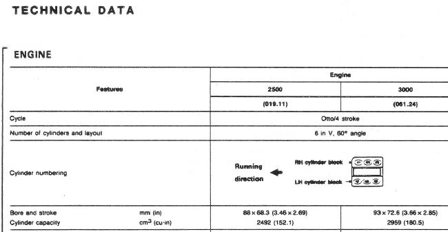

Post by papajam »
From manual PA3843.
2.5-3.0 V6 specs.jpg (29.15 KiB) Viewed 6941 times

junglejustice
Posts: 624
Location: Granolaville, WA
Yeah-yeah! That what you said...
Post by junglejustice »
The other way around.... Too many Heinies....
And by the tech data from papjam, it seems that the winner is Enzo! I dunno.... Dawie and I were looking at the numbers together, but I may have written them down wrong....
At least we agree on the piston sizes.
