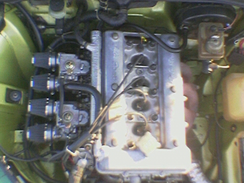

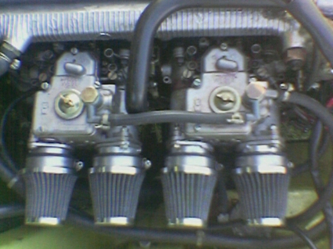

Thanks for the earlier advice. The cylinders are firing now, seems like it was the valves that were causing the problem.
I can still feel the car missing at low revs though. Its not something major, i can live with it, SORRY, i mean i have to live with it (DAMN THAT STUDENT BUDGET!!!).
I serviced the carbs, still have to get them mercury set. Im looking for an Electronic Distributor, still in the stone age with my points and condensor.
What should i try and do about the miss?
Also of i could bother you once more please? I seem to always crack the front coupling on my propshat, i dont spin the wheels at all and its only the front one that cracks. The shaft has been balanced but i somehow think that the shaft is eating the rubbers.
Most Giulietta owners i speak to have a similar prob, what can i do to minimize the damage to the shaft?
P.S This is my BABY in all her splendour!!!
Fitted the bike filters on the carbs. What a beautiful Sound!!!

Might have found the main cause!!!
Hi
I really have to thank you for all the advice that you have given me.
I took the car to get the carbs set today, it gave a good ride but gave a few scares when she missed on the freeway.
Nothing major, just a wakeup call. I service my carbs at Robin Bauer Auto Centre, he's the best with Alfas.
He took one look at the filters i had just fitted and shook his head in dismay. These filters were the supposed cause of all my probs.
He explained that the filters, although great sounding, did not allow alot of air into the carbs at high revs causing the rich petrol to interfere with the sparkplugs.
When i thought about it seriosly, i figured that he may well be right, all i was after was the sound.
He suggested i fit the K&N filters for the sidedrafts. Im goin with his idea, cant mess around with the car for a while, im taking part in the ARCSA regional rally on Saturday. Im hoping to see some beautiful cars. I will post pics as soon as i get back.
One again, THANK YOU very much
Kind Regards
Amit
