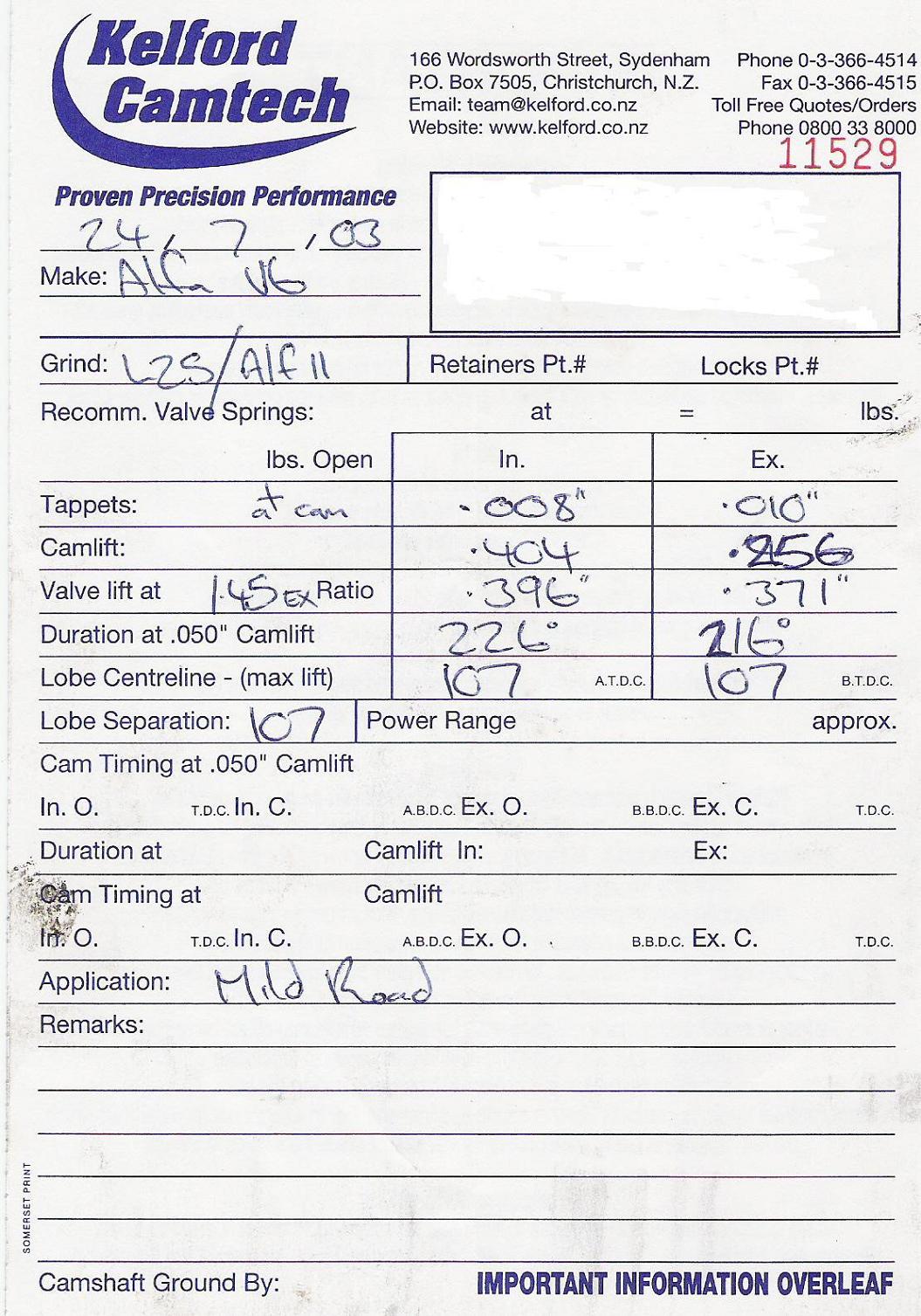

Cams Wise,
Kelford camtech in Christchurch did a set of custom grind cams for my 2.5l.
I dont think i could get the lobes any bigger unless i ground bits out of the head.
I'm sure its similar to the 164s cams, maybe someone here can tell me the differences.
How close are they?

Hey Karl, Got 2 pair of spare cams. Maybe kelfords would be a goer! They did the cams for my Fraser 7. Toyota allteza 2 litre. Ground the lobes right off, then had them built back up in different place. Cant wait to get that fired up. Noddy Murdoch is the Toyota wizard from down here, has setup the engine for me. Ported, camed, lifted compression ratio and lightened the fly wheel by a substantual amount. Reckons it will be good for 230 hp. Like the whole finised car weighs in at 580 kg. Serious power/weight combo. Shes been backburnered at the mo tho. Alfas taken priority.
Will check out Kelfords tommorrow. Thanks Tim.
