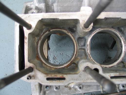

Things seem to be going from bad to worse!! The engine that I scored from the wrecker in Christchurch, turns out to be useless due to the cylinder sleeve seats being pitted from electrollisis. Soo went back to the original block wich had some indentations in the decks from the removal of the seized heads. But the head studs were also seized solid. Took it down to the local machine shop for them to (what I thought) drill out the studs and retap the threads. No! They decided that welding a dirty big nut on the top of the stud and applying masses of heat to the seized area and screwing them out was a better idea.
As soon as I picked up the block and saw the blackened alloy I knew that there was going to be more trouble. Sure enough, the sleeves, when seated back on their spots wound not spin round at all. The dickhead has tweaked the block completely. Ovaled the holes!!

Tim how serious is the pitting of the liner seats in your block ? I as well as many others have had success filling these "pits" with JB weld and then sanding the surface smooth.Obviously this will only work if the surface isn't totally chewed up.

The pits are not too serious. I really would like to have a minter engine though.

Tim JB Weld is a two part epoxy resin/catalyst.Its nice to work with because before it begins to set up it's "creamy" and can be spread quite smoothly over the surface.Once it hardes it's not going anywhere.Any chance you can show us a picture of the pitting in your cylinder bores ?
Cylinder seats
Heres a couple of shots that dont really tell the whole story. Quite hard to acurately capture. But the pitting ranges from a nasty eaten out chunk from the inner block wall close to the seats, to some pitting on the seat sufaces themselves. The rusty spot you can see on the pics. They average aprox 1-1.5mm deep.

Tim I agree that it's hard to tell from the photos. From what I can see I'd try the epoxy. I guess we're talking about a seal that has to resist the max pressure of the cooling system while withstanding the heat transferred from combustion down the cylinder barrels. My engine had numerous little divots right on the "sealing” surface in 3 cylinders and the JB weld worked fine. This one calls for a knowledgeable second opinion considering the work involved if my suggestion doesn't work.
